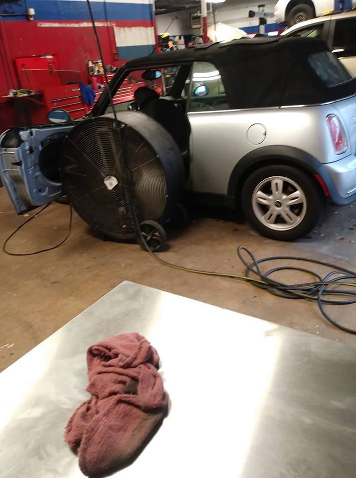

THIS WAS A SCREENSHOT OF A VIDEO I TOOK OF THE CAR AFTER THE FIRE. LOST THE PS PUMP, RES, AND THE WHOLE BACK HALF OF THE WIRING HARNESS.
AND SINCE I LIVE IN FLORIDA AND MY WINDOW LEAKS, THIS IS A REGULAR OCCURRENCE AT WORK, AFTER OUR AFTERNOON STORMS! XD

You can adjust the window up to stop it leaking. I used a shock adjuster wrench, worked great ( I tied a string to it so I didnt lose it down the door). Bentley has a good writeup on how to adjust it, its on here somewhere.
Also, check the rubber foam at the front side of the window under the pillar cover. Mine was disturbed and leaking there. Water will work its way down the pillar and by the fuse box, which is bad. I caught mine as soon as it happened.

Window regulator is broken unfortunately. Waiting for funds to fix it until ive financially recovered from the fire... Luckly it leaks at the back end of the drivers window away from the fuse box. But none the less a close eye is kept on it in the rain.
