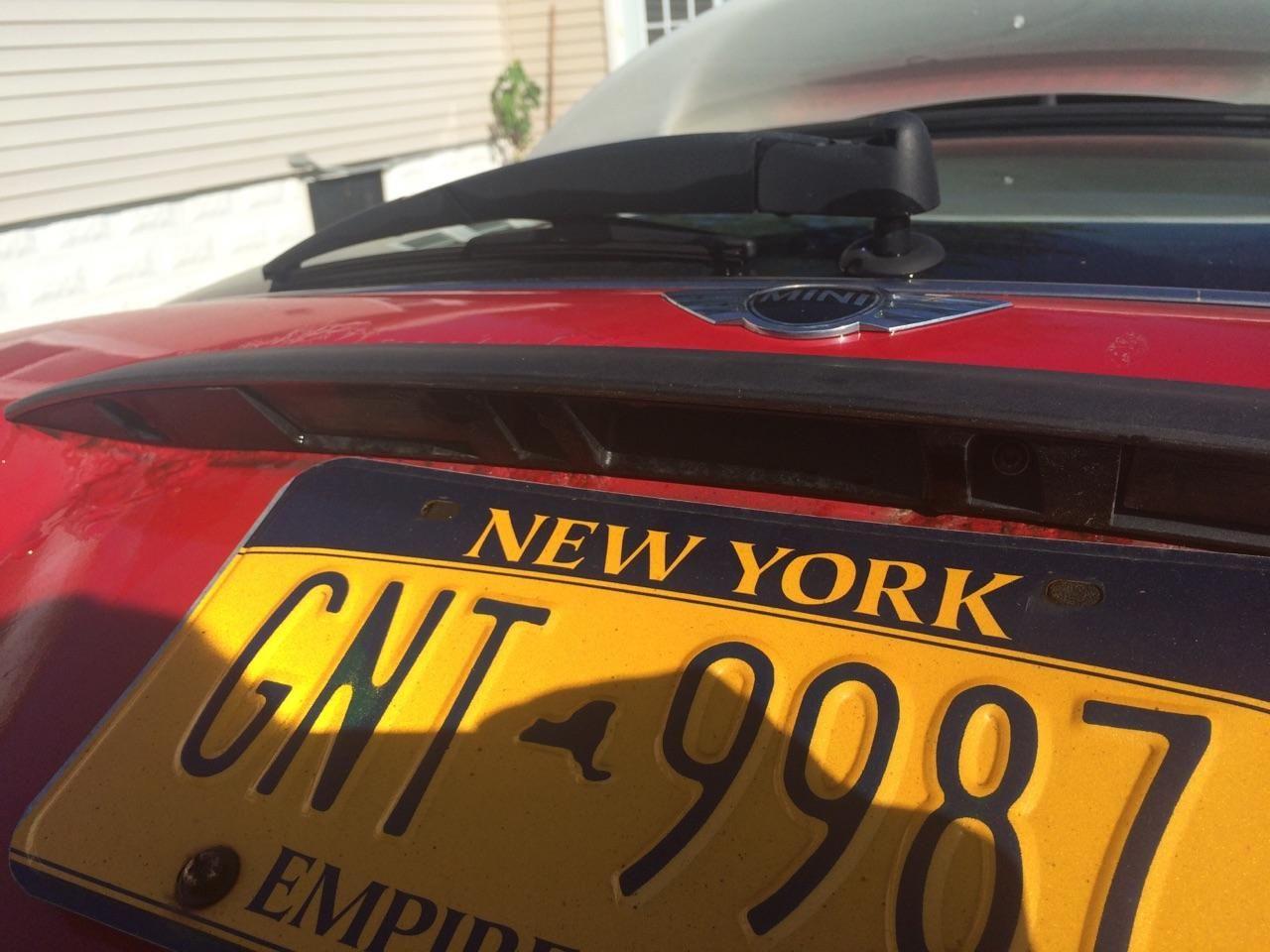

Okay, very good to know. The seller of the '06 seems to be really proud of how clean and well taken care of the car is. I'm interested by what you said about the 87 octane, I use nothing but 91 ethanol free but most people just schlep along in life using the cheapest fuel at the pump, I would think that manufacturers would have realized and accounted for this, no? What kind of/how extensive damage can it do?

I just spoke on the phone with the seller of the 06 and the seller of the 05 (separately of course) and they're both going to be sending me engine bay pictures. I have some photos of the rust on the 05 that apparently developed last winter, just after the warranty ran out.
The 05 seller said that he hadn't changed the coolant in the 2 or so years that he's had it but it was topped off because there was a small leak from the top radiator hose (has since been fixed). He said that you could tell that it was flowing well through all the pipes and hoses. He does oil changes every 3000 miles with full synthetic.
The 06 seller also hadn't changed the coolant in the 2-3 years that he's had it but he's close friends with the previous owner that he bought it from and he changed the coolant just prior to selling it. He does oil changes every 5000 miles with full synthetic and there is absolutely no rust on the car.
Both owners are using premium fuel with accordance to the owners manual.
I'm thinking I like the 06 better just because it's completely rust free and coming from upstate NY, I know how rare that is. (I also like the blue better). I'll be posing engine bay pics as soon as I get them. I also should be getting a service record from the owner of the 06 and I can post that as well
Old Jul 6, 2016 | 10:43 AM
ZippyNH's Avatar
ZippyNH
Joined: Sep 2009
Posts: 12,605
Likes: 41
From: Southern NH
Rust like that takes YEARS to grow....I'd run. That car is a rolling piece of scrap metal...will fail a simple state inspection within a year....too many good ones around unless it was a $1500 car....
These motors are high compression, with a hot intake charge due to the sc...yes, there is a intercooler, but when the car is sitting for a few moments at a stop, lots of heat, and ZERO airflow...the car can reduce the timing and ennrichen the mixture but it can only do so much.
The factory REQUIREMENT Is 90+ octane on ALL GEN1 (R50,R52,R53 CARS)
RUNNING less makes the valves run very hot...they then soften, and wear very fast...net result is the car needs a valve job due to lack of compression best case, worse case, has a pistion or head crack from knock....
Some folks claim 87 is ok...driven gently it can sometimes be ok for a bit...but the bill will be big....lots if cars have threads where the owner does plugs, wires, coil..and says I still have a misfire?! it rapidly gets worse...and becomes underivable. Sometimes the new parts help long enough to sell the car to an unsuspecting buyer....

Interesting, I think I'm going to (politely) abandon the 05. The owner of the 06 only ever runs 93 from Sunoco and I can definitely speak for the high quality fuel that Sunoco sells.
