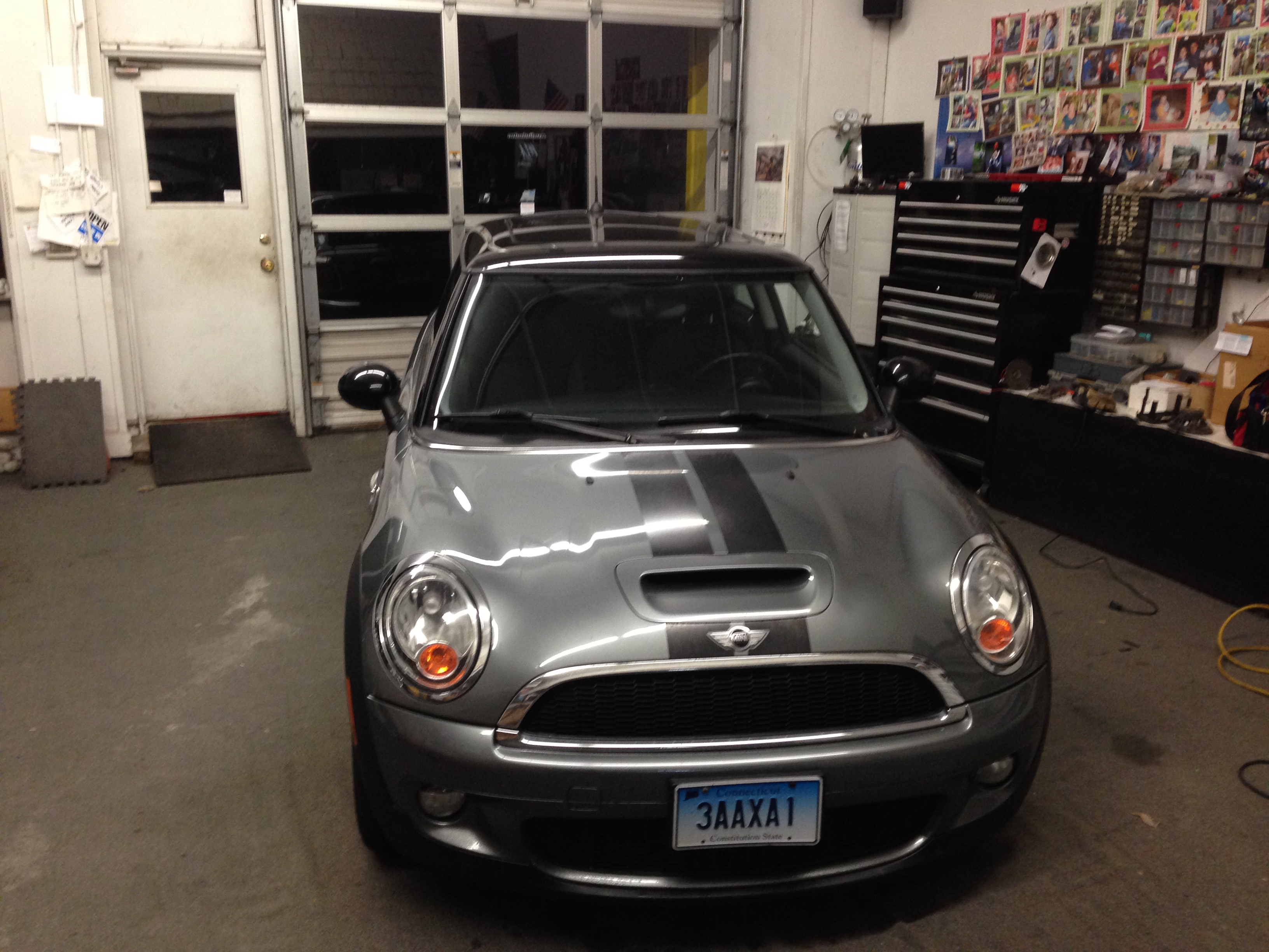

So it's been almost a year! Thank you for your reply. At this point I've done just about everything that I had on my list and then some. I just wanted to say thank you for the how-to section in your website, I enjoy looking through all of the different DIY stuff even if I don't have to do them! Yesterday I took on the task of cleaning the valves, at 105,000 Miles they needed it. You were right about the walnut blasting, it really worked well. I haven't had the chance to drive it yet but I imagine there will be a considerable difference.
