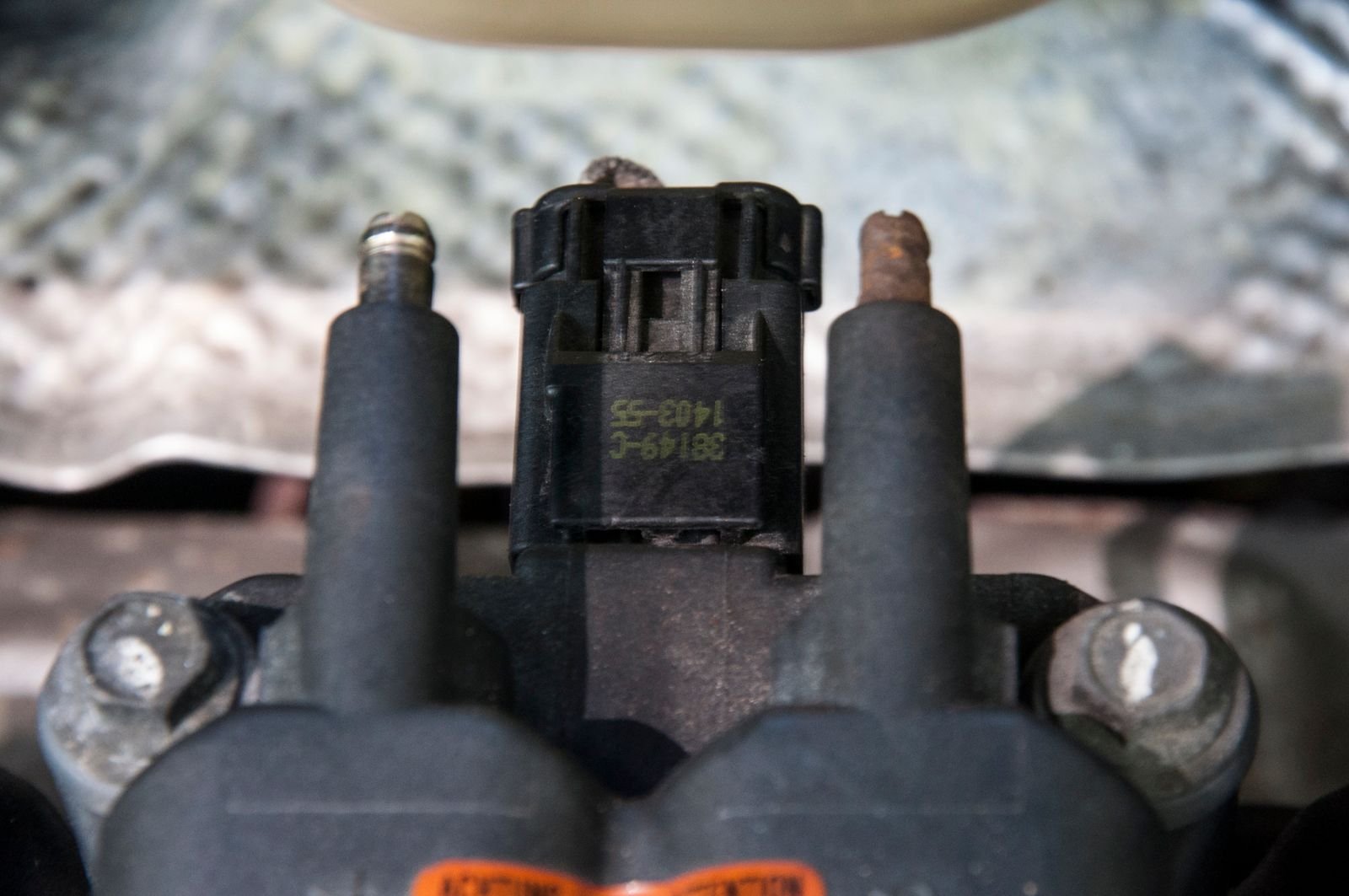

Figured out the part I need with the spark wires connecting to it is the ignition coil. You can tell I'm not very good with cars yet
Part number 12137510738 and $125 later will hopefully keep me misfire free for the next 100k! So hopefully $422 (the total for the ignition coil, window regulator and motor) will put the car in near perfect mechanical condition!

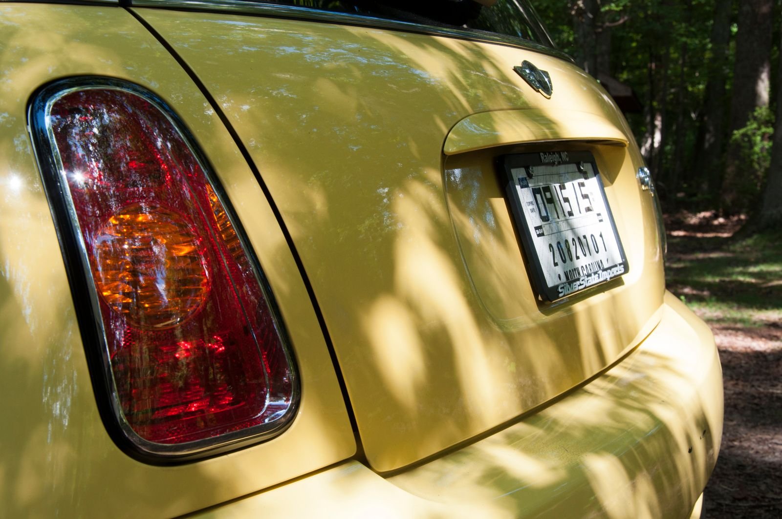

Alright, did some cosmetic work today. Like I said earlier, if I had known my window was going to fail and my cylinder 3 coil was rusted I wouldn't have done this, but it's nice to give the exterior a little refresh
Both taillights replaced, though it was mostly the left one that was really foggy and ugly. The back is still really dirty, I'll be doing a full clay/wax routine on Saturday.
Front emblem replaced.
Cracked and taped passenger side A pillar cover replaced. I guess it'll look a little lopsided, but the other side is in pretty decent condition and you can't see both covers at the same time so I didn't bother matching them.
New rubber floor mats! I am glad they didn't turn out as gray as I thought they would be. Look really nice.
Up next is the window regulator and motor, plus the ignition coil pack. I will actually be broke after buying those three things so hopefully I won't have any more issues for awhile!

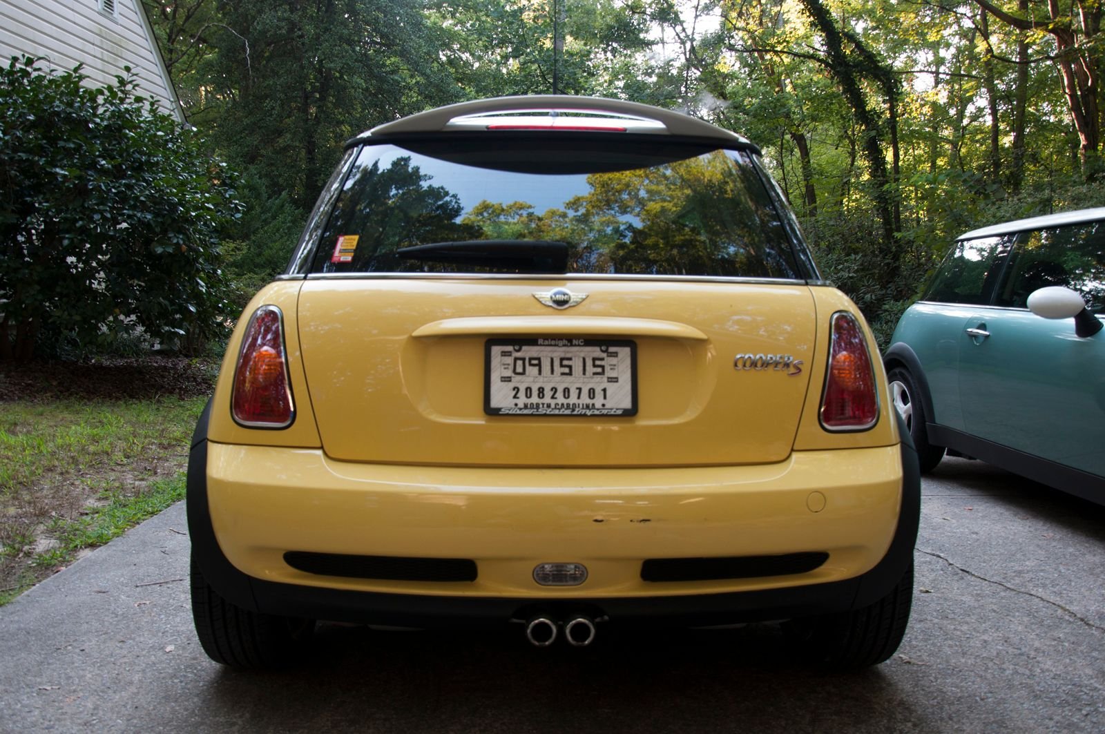

Forgot to take pics after the Mini's detail on Saturday. Here's a few from today:

So the ignition coil and window regulator assembly came in from eBay today. I'll replace the regulator with the motor whenever that comes in, but I wanted to go ahead and replace the ignition coil today since my cylinder 3 coil is pretty corroded. I checked my Bentley repair manual and I got to the step where you remove the electrical harness from the coil and it says to slide the locking tab to the left to unlock the harness. I don't have a locking tab. It's gone. I checked the PelicanParts guide and it says the same thing. I have no locking tab at all so the harness won't slide off no matter what I do.
Sorry the pics are a little out of focus, had trouble holding the camera steady.
