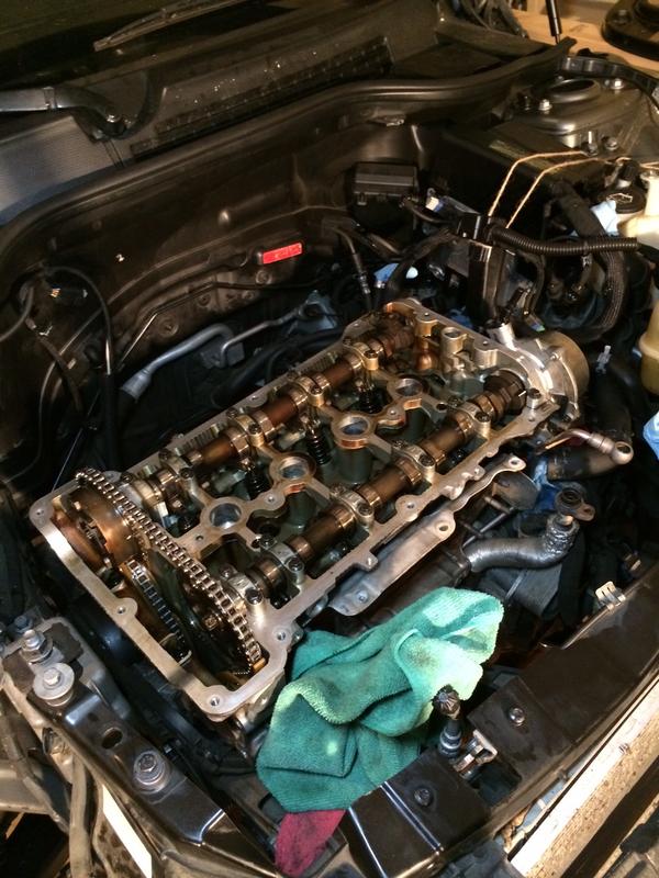

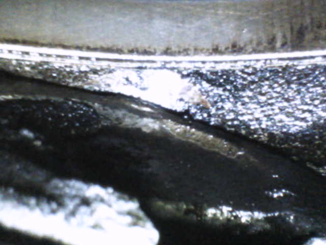

The current drama - a couple months back it hit heavy hesitation and started to misfire on multiple cylinders. After lots of weekend diagnosing and a few replaced parts, I borescoped my cylinders and found a chunk missing from one of cyl #2's exhaust valve. So I sat on that for a bit - knowing that I was quoted ~$3500 for the fix. This long weekend was my opportunity to pull the head myself, and so now the car looks like it does in the attachments. hah. Honestly I don't know if I could've gotten this far without this community so I wanted to stop in (and make some good use of the used mini parts too).
I'm currently stuck trying to get the cam gears off to get the chain off but I think I've stopped to wait for the locking tool so I don't stretch the chain by holding tension at the crankshaft. Almost got the head off without the Bentley or the tool! I definitely see the need for it going back on now though.
