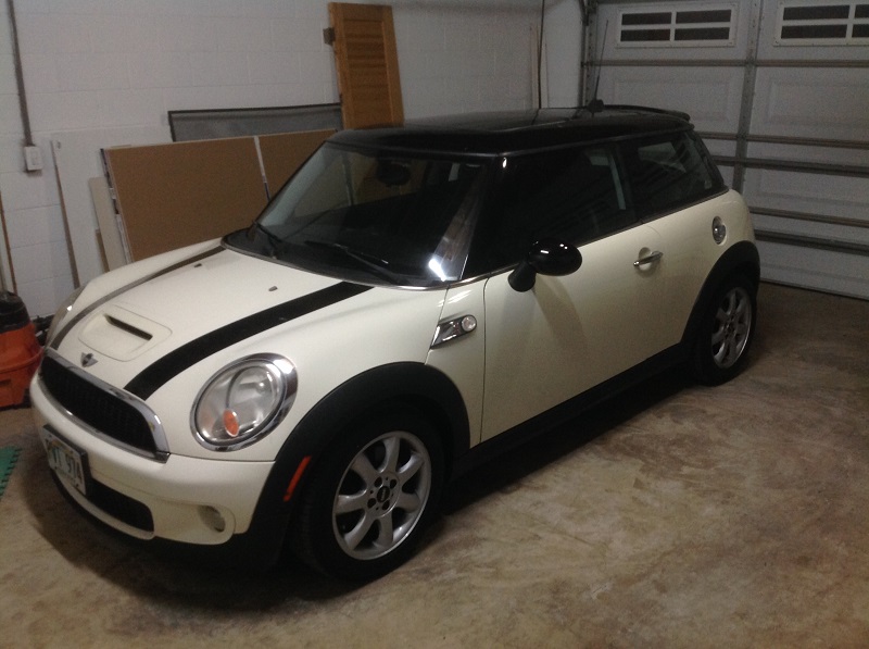

Got my new-to-me 2008 Mini Cooper S (R56)!
I love it. I had to rescue it from the previous owner who didn't know how to care for a car. She fooled me though because when I bought it, there was no engine light or other warnings lights to indicate a problem. Inside is immaculate and the outside only had some minor paint chips from freeway driving.
After I drove away and 20 miles later, the engine light came on.
Had to shake my head on that... Meaning that the unscrupulous seller had a way to reset it. Oh well.
I got the infamous Kazoo sound on engine off a week later. Then I got the oil light coming on intermittently at low RPM. I have my work cut out for me it seems. No biggie, it's a hobby for me. She's my new baby and part of the family.
