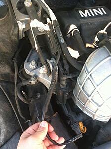

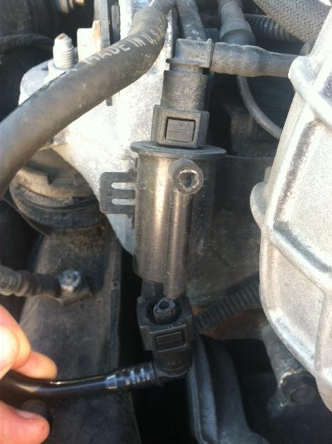

Hey everyone decided to make an account today in search of some help. I recently broke what I believe is a vacuum line on my r53. But I'm not 100% sure and would like to know.
If anyone knows what I broke please let me know what it is and what the ill effects will be, and maybe what part I need to fix it thanks.

If your having trouble viewing the photos right click and select open in new page/tab depending on your browser. I would really like to know what I broke

Figured out how to upload pics finally. So if ya know what I broke let me know, it seems important lol

Im sure its the Fuel Tank Breather Valve, look at part # 13907572086 on realoem.com

Yup...
You WILL GET A YELLOW check engine light and an evap code....
Mini sells the valve for $80 ish, but a few folks found it is a common part...sold for $20 ish if you do some searching...as for the hose...you can order a new OEM hard line....or maybe convert to a rubber/silicone flex line.
