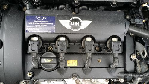

Not sure if the picture shows it well enough, but there is oil under some of the bolts. Is this a valve cover issue or a gasket issue?

Looks like you need a new valve cover gasket. No new parts for 09. Next gen. For that motor was 2011. Some say the tensioner was updated during the great chain fiasco. A concave end/head is the new one.

It's a little blurry but make sure it isn't leaking from the valve on the top in the back. That is the pcv valve. If that it was is leaking you will need a valve cover assembly. Also it could possibly fail and stick causing lean running and mixture adaptation faults. Or a valve cover gasket if its only on the top of the cylinder head.

Yeah that's what I thought. Is it better to replace the cover with the gasket at the same time? Going to look at an 09 MCS tomorrow that has a few less miles

No if it's good then it is good. Valve cover assemblies are close to $500 if I remember. Also the labor shouldn't be more than 1.5hr. It is pretty straight forward.
