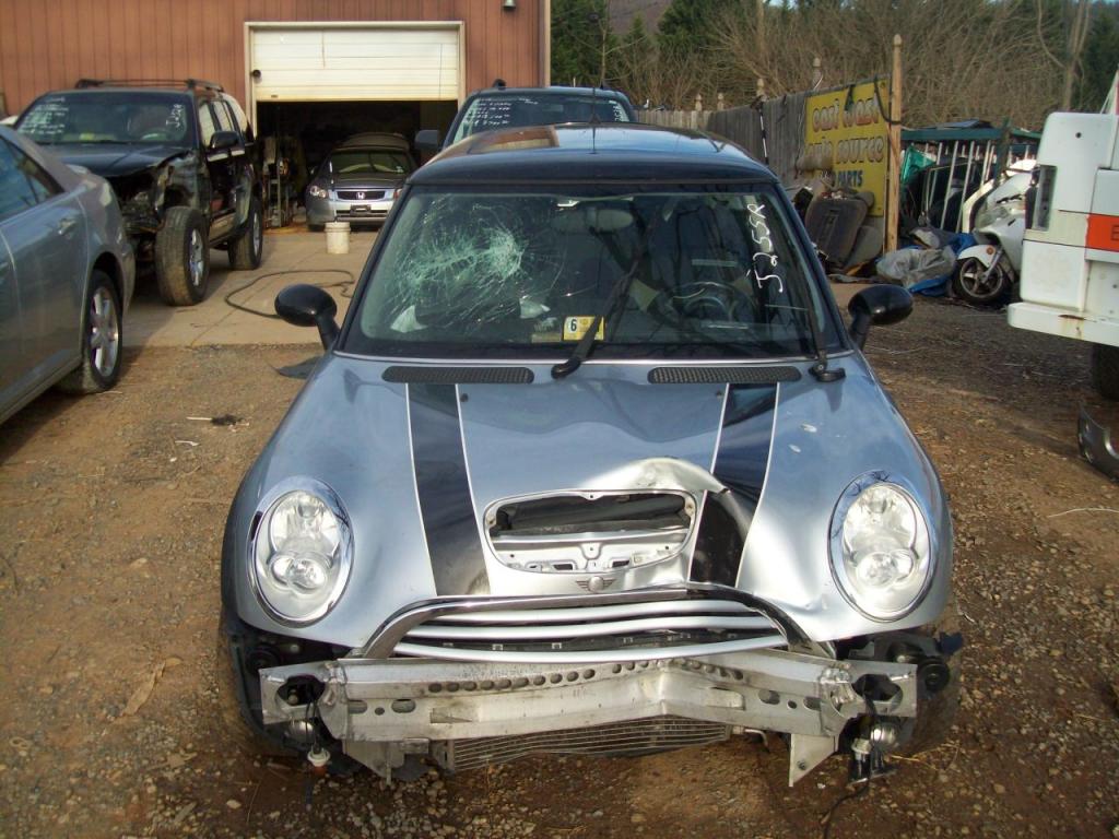

Well, I have been driving 500+ hp mustangs over the last 8 years and decided I finally needed something good on gas. I knew it would need to have a small engine, but I didn't really want to compromise its fun factor. I ended up driving a few Minis at work and decided that would be the perfect car, but the prices were just too high for my second car so I started looking into salvage yards. I found a 2005 MCS that had been wrecked, but it fit my budget perfectly. So, I bought it, and have been in the process of fixing it over the last couple months in my free time. I have browsed this forum during that period and have found very helpful information about the car. Decided it was time to start posting and opening up a build thread.

Doesn't look too bad. Hard to tell from just one pic but appears to be about $6 or 7 thousand in damages.
Going to build it close to original or have some upgrades planned?

Yeah, I found some that were in much worse condition, but since I don't have a full shop just a home garage this one seemed easily doable. I was told it ran and drove, but when I went to pick it up I found out the engine had been pushed back almost to the firewall, all but one motor mount was busted, steering rack was snapped in half, and the transmission had a hole in it. So we worked out a deal with them getting my some parts. Still a longer project than I was hoping for.

Lol, yeah it looks as though the windshield was cracked by the passenger side airbag, and not a head. At least that's what I'm hoping.

Yikes, much more damage than the first photo showed. And with airbags deployment too? More like $10-12k in damages. Yep.... quite a project on your hands.

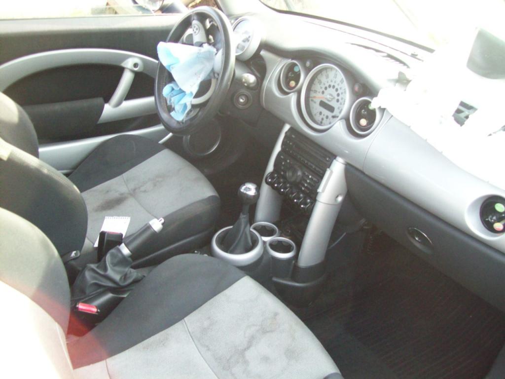

Speaking of seats looks like the past driver of your car did not make it
home with clean fruit of the looms that day
Lol, yeah I'm not sure what that was. I've shampooed the seats, and it cleaned them up some, but I am thinking I will eventually throw in some JCW seats or something.

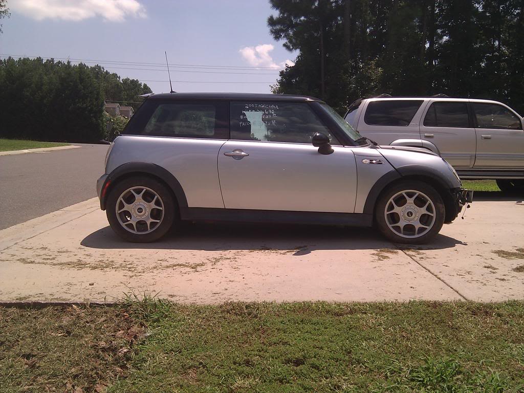

This is how it sat after I got it.

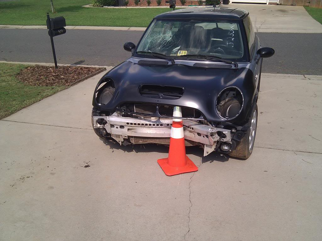

After the old hood was removed and fitted the new unfinished hood with a cone sitting in the damaged area lol.

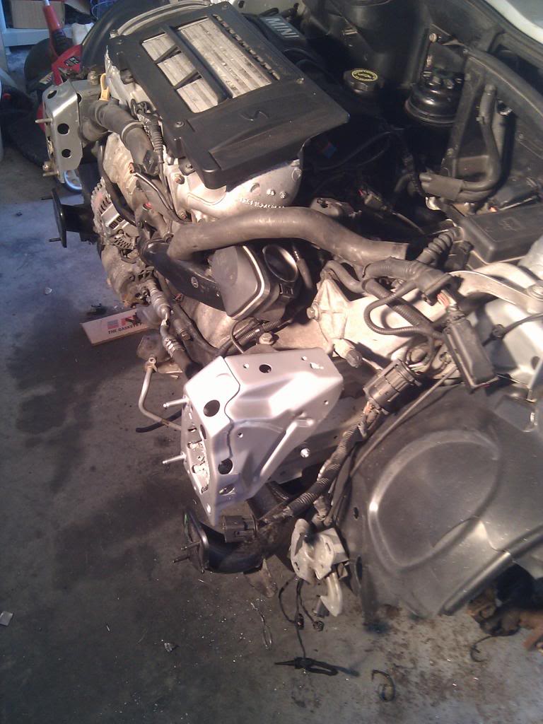

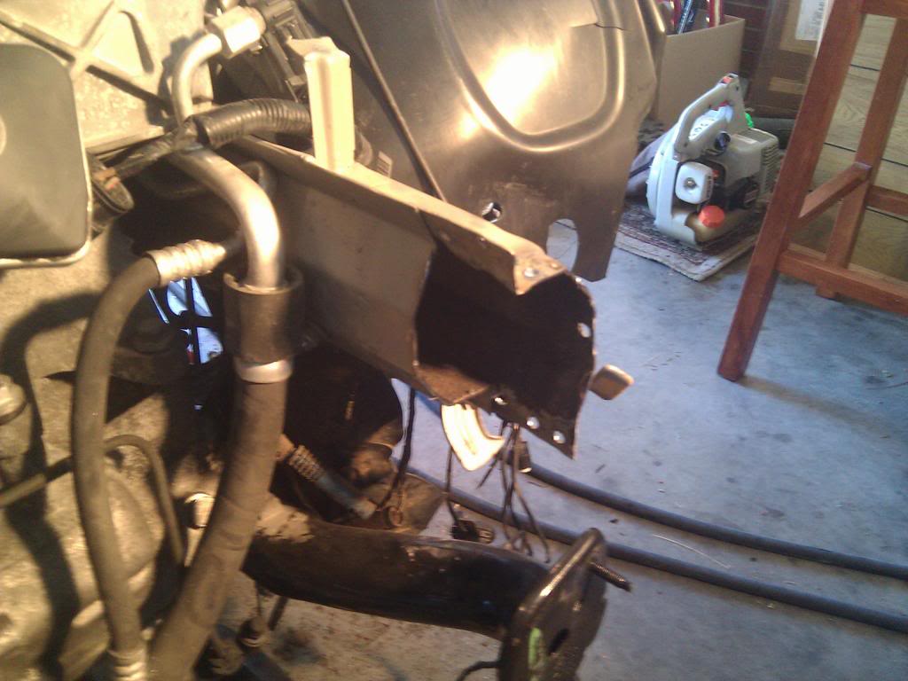

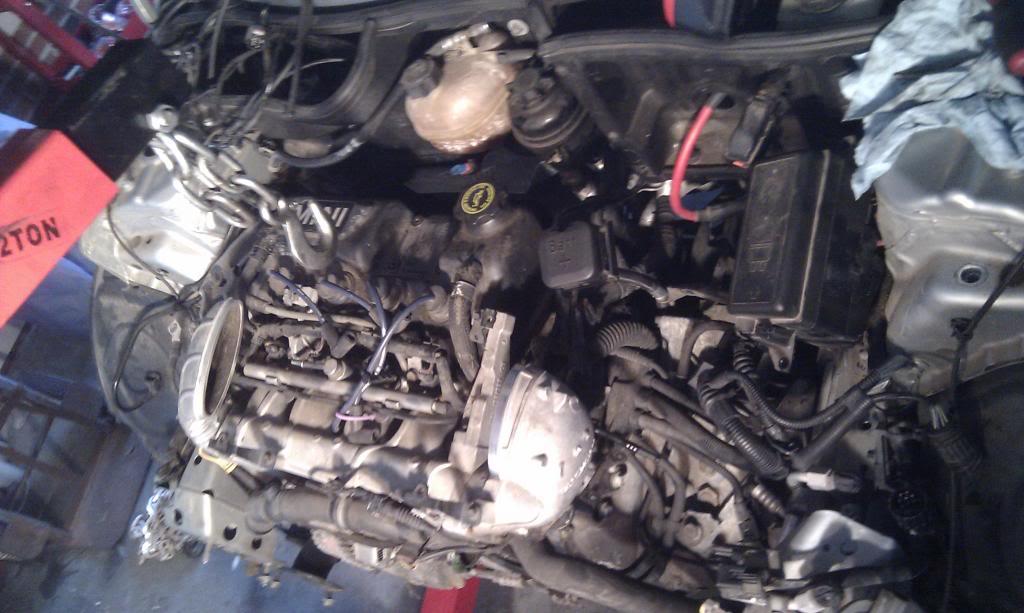

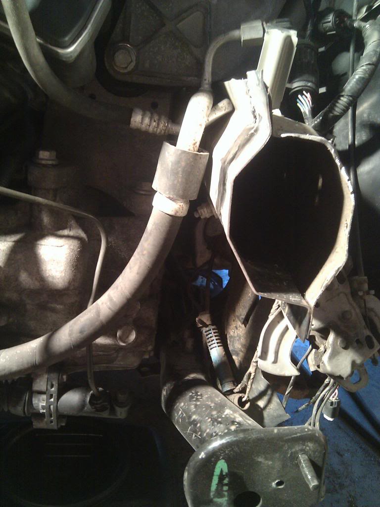

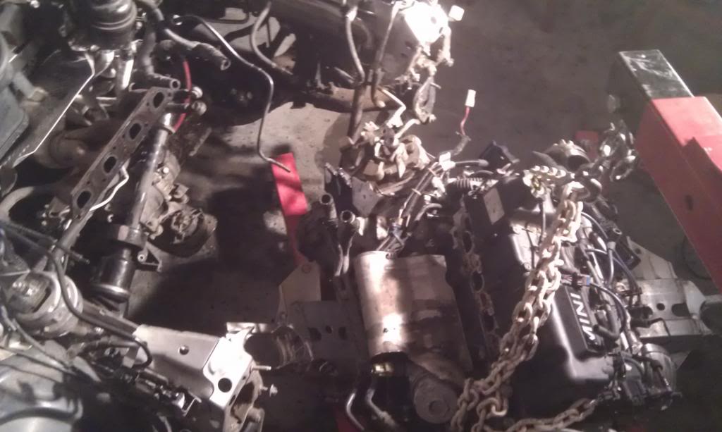

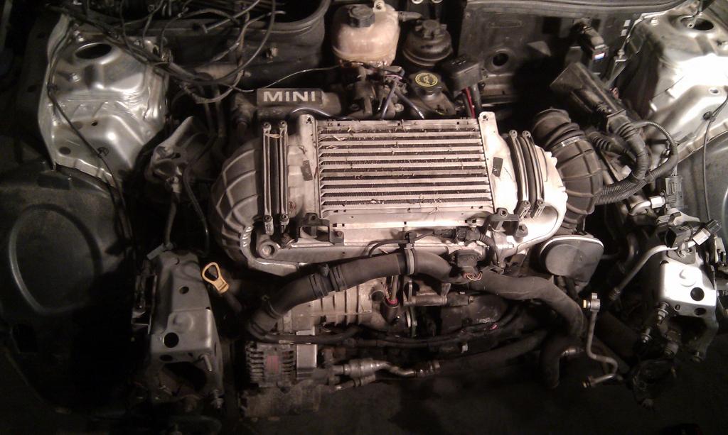

Because the engine had been pushed back I had to remove it, put a new transmission on it, replace the bent subframe, replace the steering rack, and then drop the motor back in. You can see the bent frame in a couple of the following pics.

Intercooler off

Engine out

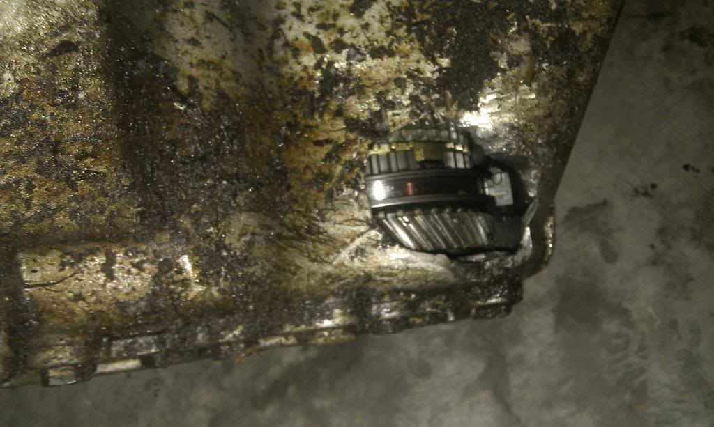

Here is the hole in the transmission case.

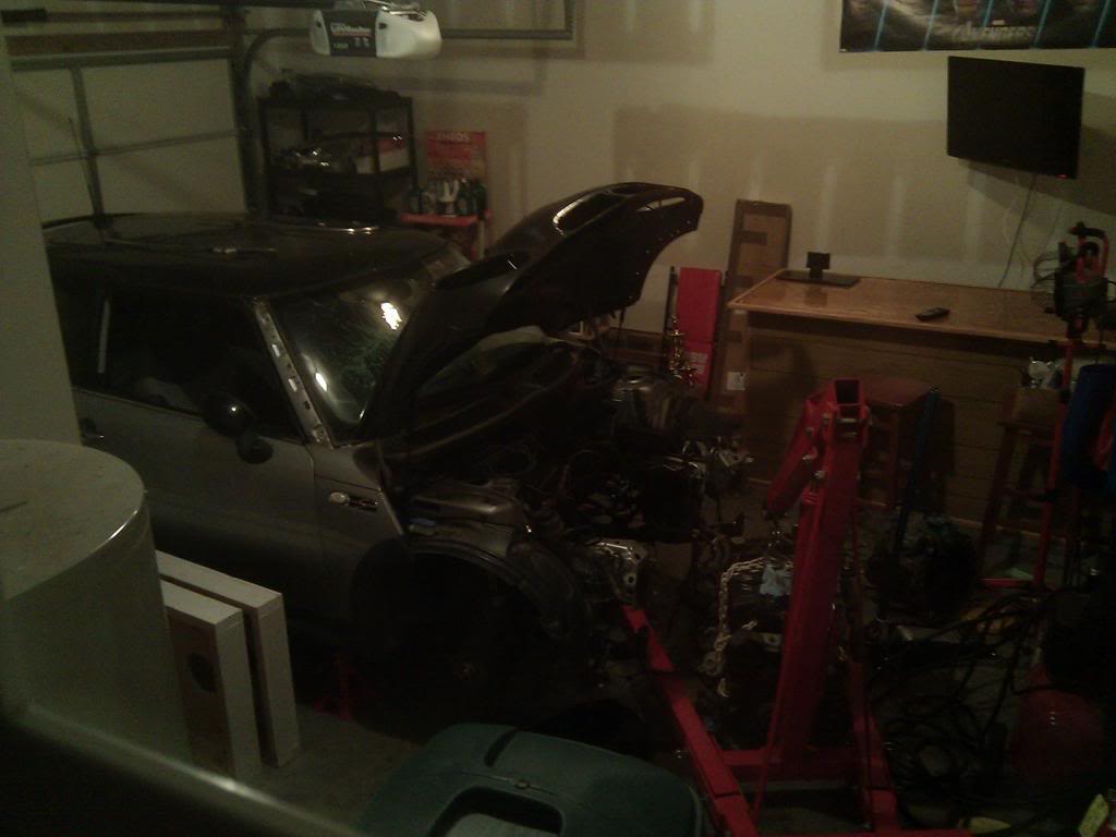

Tight work area. Tv for car shows

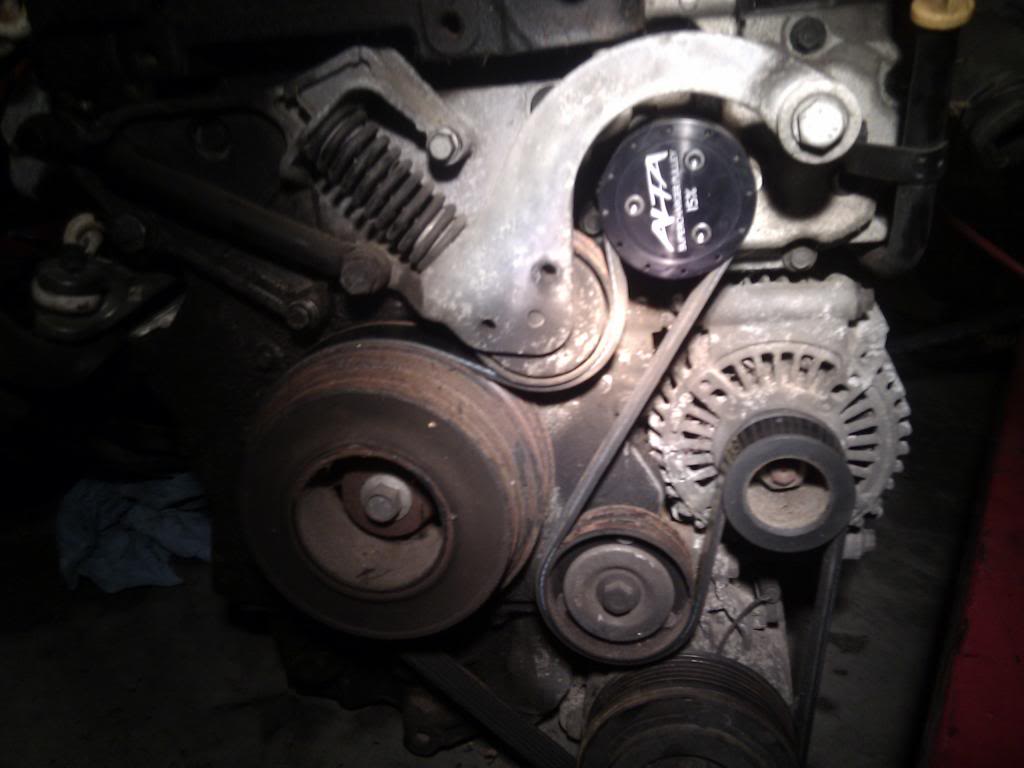

Figured while the engine was out I would upgrade the pulley. So on went an Alta 15% reduction pulley, new belt, and tensioner stop.

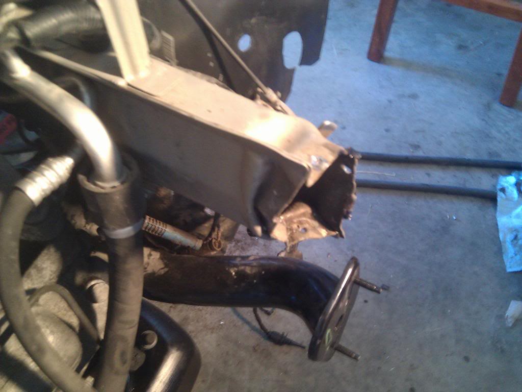

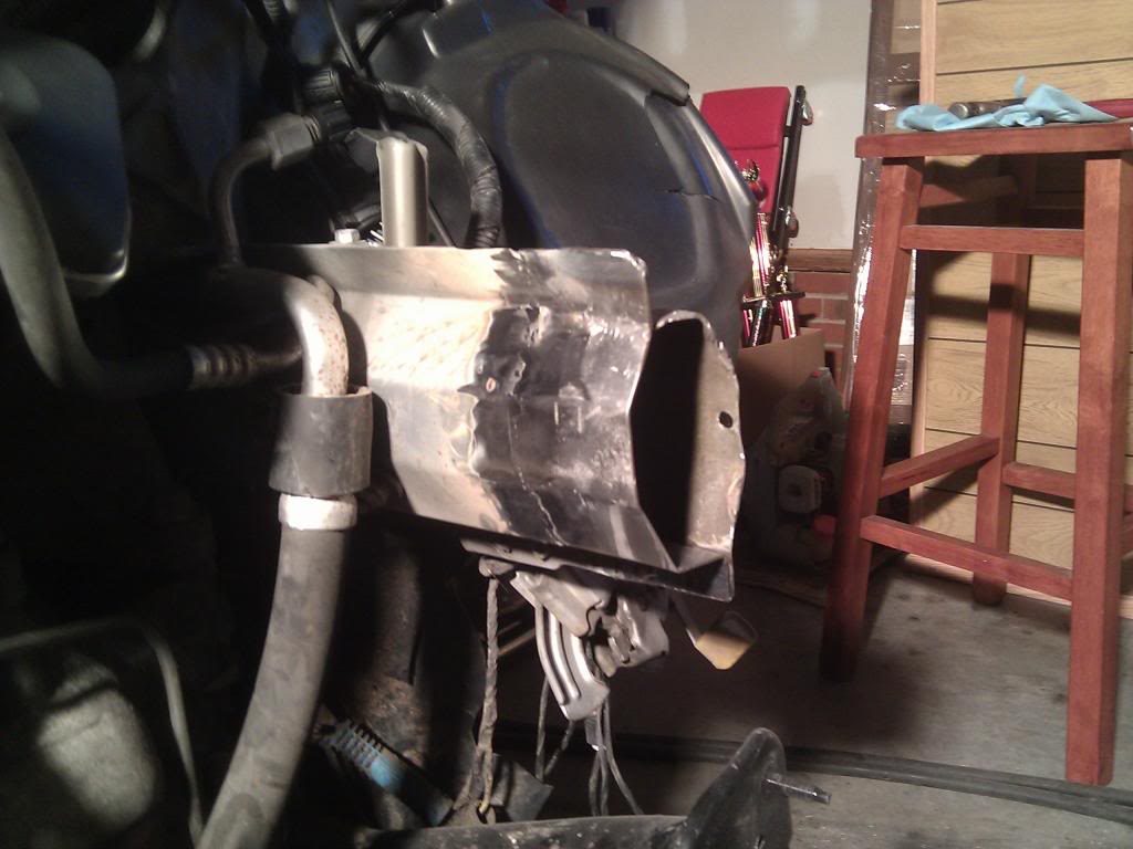

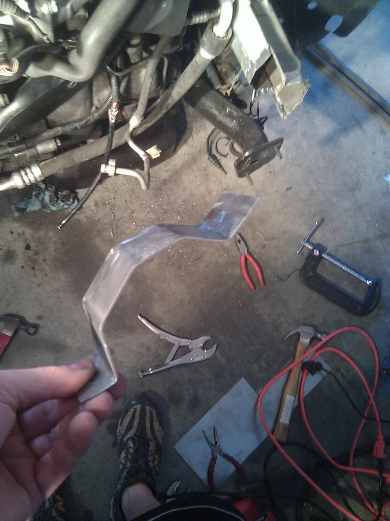

Driver side frame rail after I cut the bent frame horn/end off. Passenger side was not bent much and was straightened with a large hammer.
I cut the damaged area off, made a new piece with 16GA steel, and then welded it in place, followed by a new frame horn purchased from the dealership. Then covered with a couple coats of silver to prevent rust and match the rest of the car.
