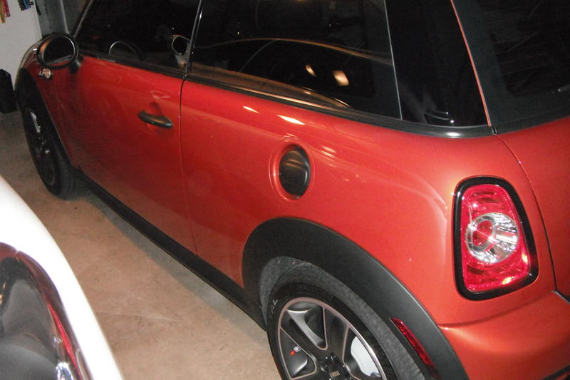

I did my headlight and tail light chrome trim in vinyl, the same vinyl as the stripes. My door handles and gas cap cover are from Aesthetic Creations. Beltline is Scotch Super 33+ electrical tape and the grill surround is the JCW trim from Outmotoring.

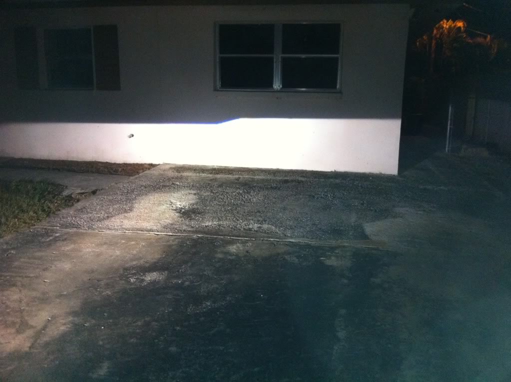

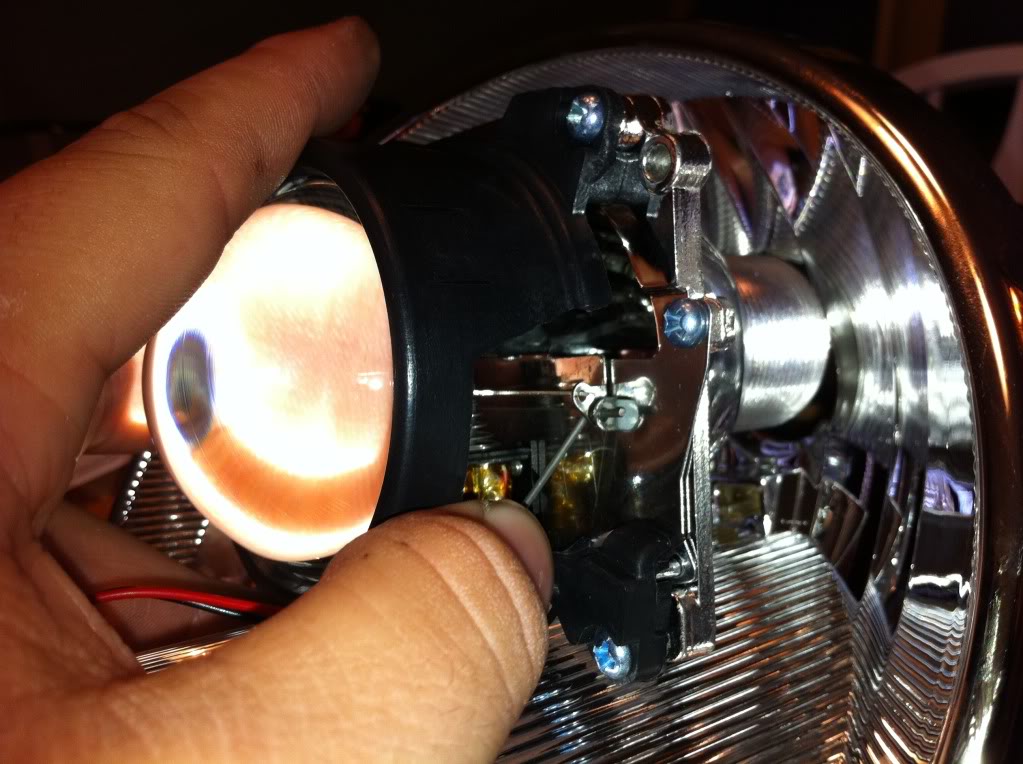

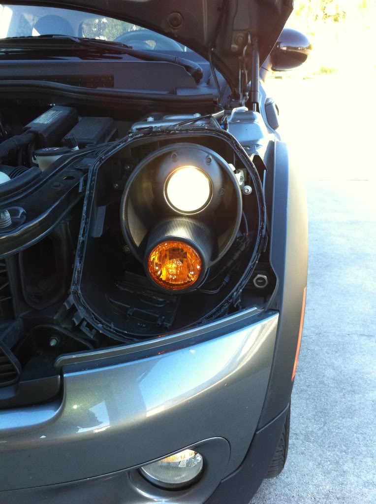

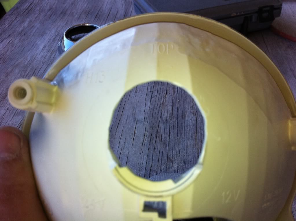

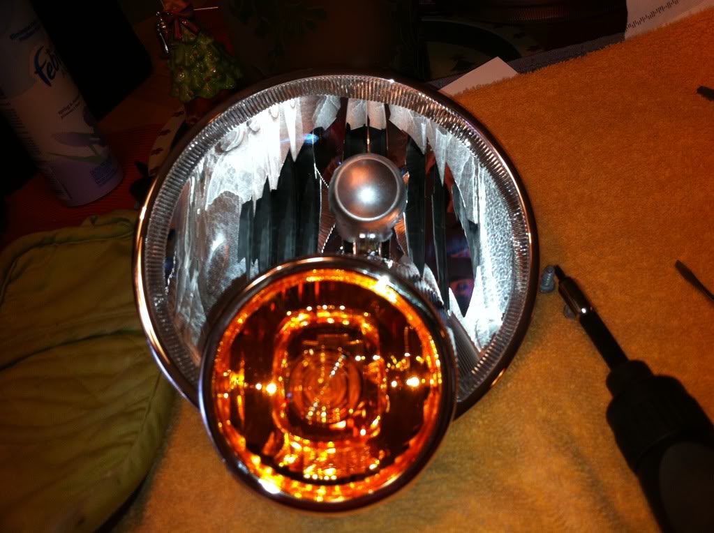

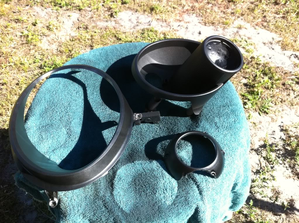

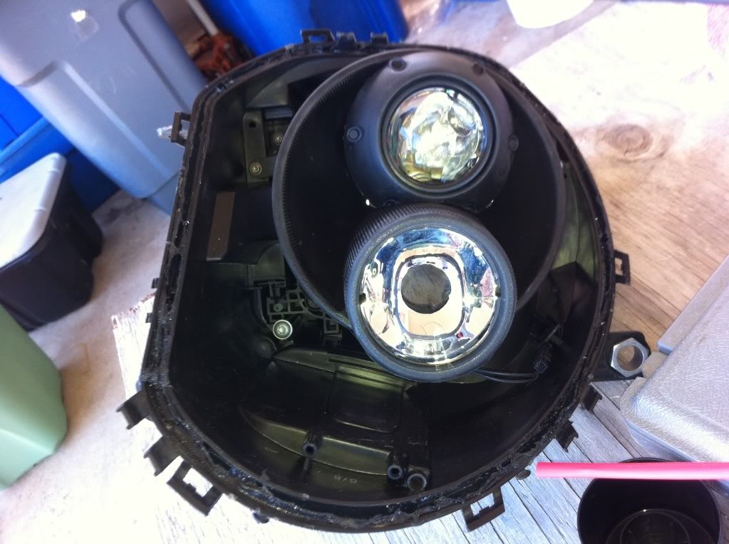

I paid $300 for everything I needed to do my retrofit from TRS. I used my stock housings and 1 can of plastidip. The HID kit did not need any resistor or bulb-out kits and I get no errors on low or high beam.
Here are a few photos...

before aiming
