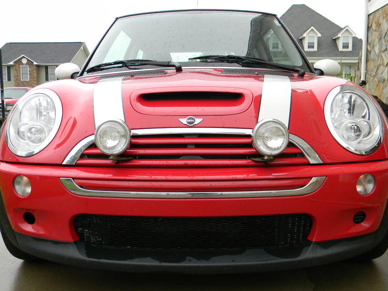

I really like the black mesh look on the JCW, but I don't want to order the grille set unless i know i can install it. Is this possible? even if i have these fog lights?

You have an R53, and mesh grill for it actually comes from the aerokit (not a JCW product).
The upper grill will fit fine but you'll have to cut openings for the light brackets, as described here: http://www.motoringfile.com/howto/Dr...Lights_902.pdf
The black mesh lower grill is designed to fit on an aerokit bumper, and requires modifications to fit a standard bumper. This thread may help: https://www.northamericanmotoring.co...lor-coded.html
