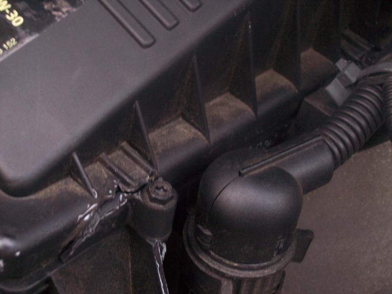

Here's a picture (if I uploaded it right!)...you can see the crack at the front bolt really good. The back is cracked too, but because of the hose right next to it, the area's hidden. You can see where my son tried some JB Weld on it - didn't hold, but he also didn't let it sit up for long, don't know if it would have worked or not.

Go aftermarket - it's cheap and it'll help the car breathe a little bit!
I don't think JB Weld will work either! Check out this video...
http://www.wonderhowto.com/how-to-re...aboard-290765/
There are similar products on the market if you don't want to go with this brand. The brand shown in the video, TAP Poly-Weld Adhesive, cost around $14.00 for 1 oz. which should be enough for your job. I'm pretty sure the filter housing is Polyethylene, but check it to be sure!
