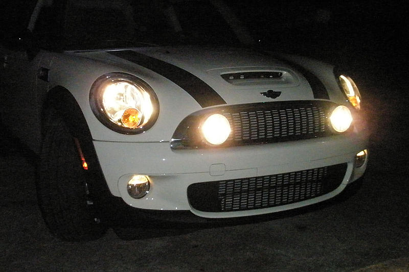

On my first Mini. I had the dealer install the Driving light Kit. They mounted on the existing Grill. When the dealer installed this kit. I was unaware that my High-beams had to be on before I could engage the Driving Lights.
So in my case they looked real cool but not terribly functional.
I purchased a second Driving Light Kit for my new new Mini and I'm going to request that I can switch them on independently of the other lights.
As far as I'm concerned they are must have accessory because they look so cool.
Here a horrible picture of them on.
