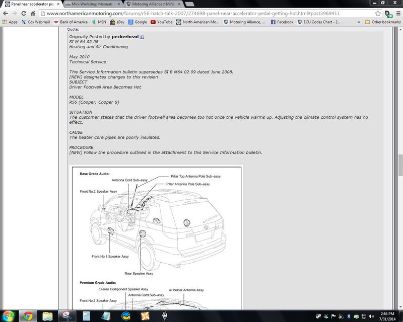

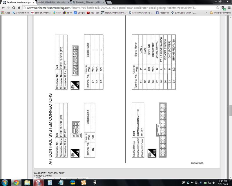

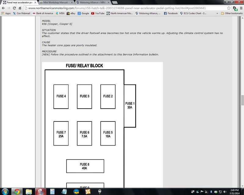

This thread needs some serious attention, peckerheads included service bulletin information shows something different every time I revisit this thread. It's on transmissions now, before it was on cylinder head removal. Go ahead and see for yourself by refreshing the page and you'll see something different each and every time!
I need the information that was there the first time.

Does Not look that way to me, have a look. Everytime I refresh the page it's something else, now we are on car stereo!
Attached Thumbnails Panel near accelerator pedal getting Hot!-ms.jpg   Panel near accelerator pedal getting Hot!-capture.jpg   Panel near accelerator pedal getting Hot!-mss.jpg

I can confirm. Every refresh is something new. Not the TSB images that go with that number.

Ha ha, that's funny. On the phone app it's the original and doesn't change. On the computer it does.

That's hilarious. I'm seeing the same thing. All I did was cut/paste from Alldata LOL.
