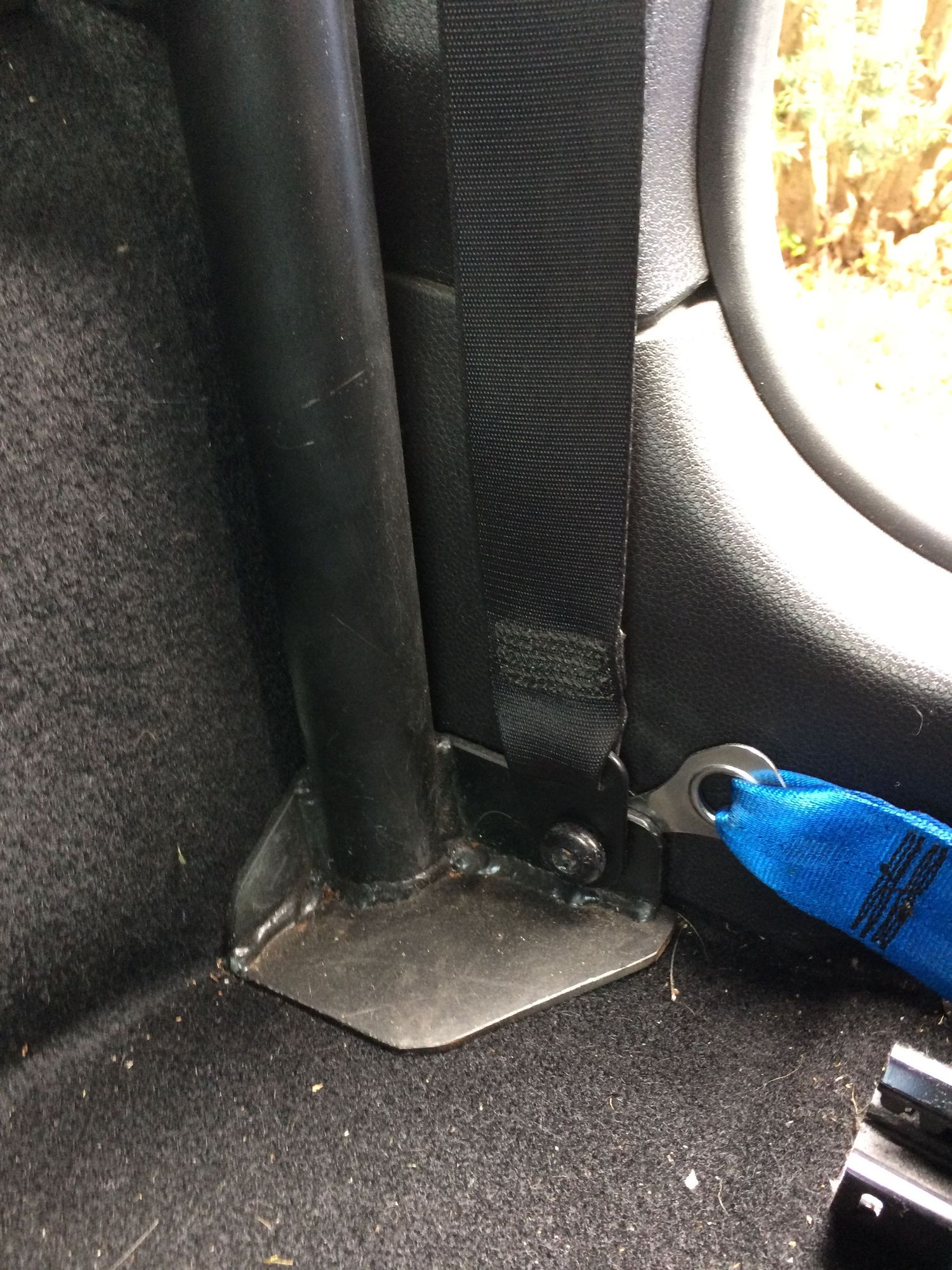

Lower mount for the roll bar. Uses the seat belt mount to retain it in place. The hole in the roll bar plate is large enough to allow the carpet to compress in a rollover and not shear off the seat belt bolt.
