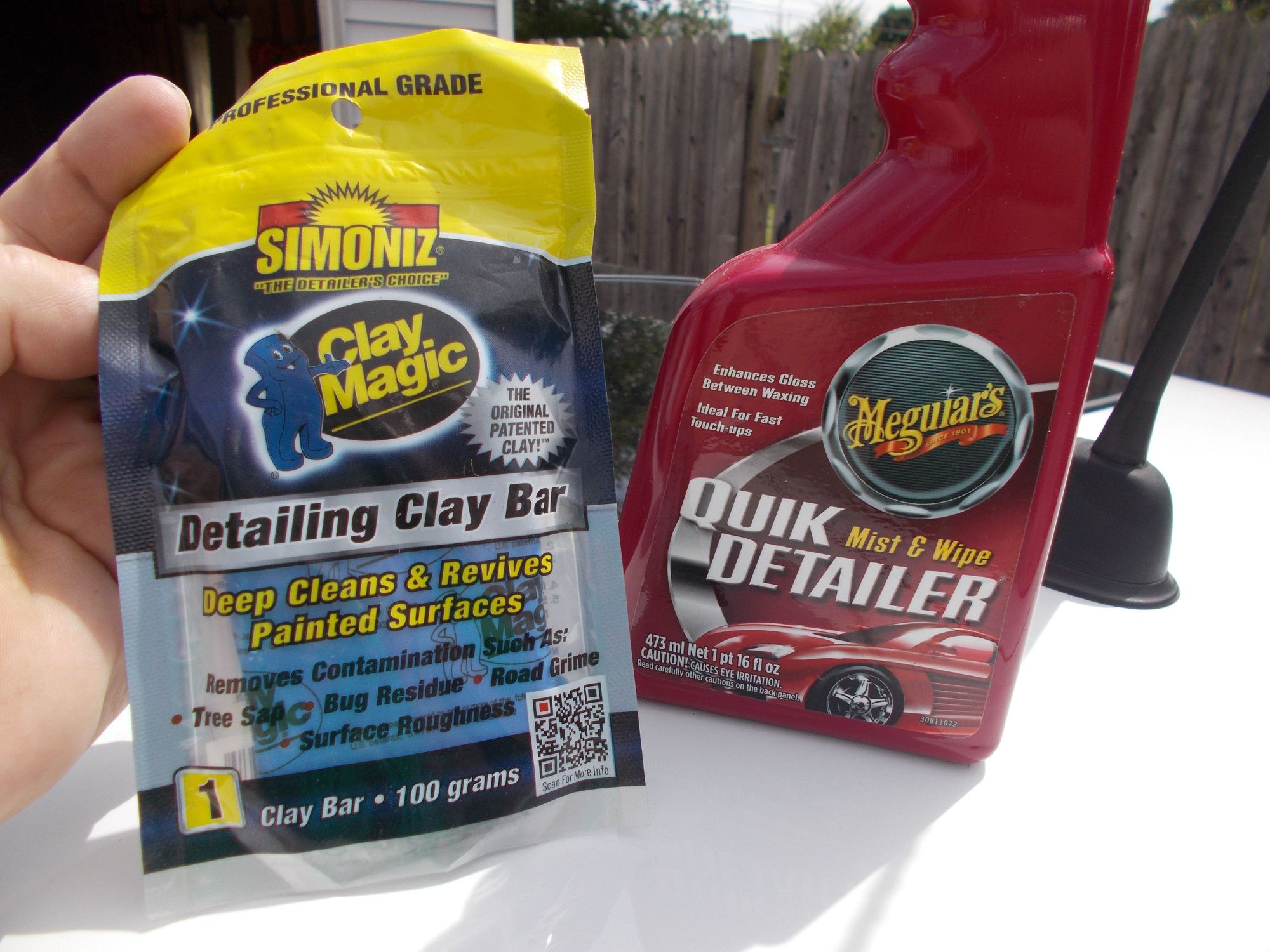

CRC August 25, 2019
Next step is to clay bar to remove the particles from the paint. The Simoniz is a good quality clay bar, and any detailer will work. It's only to lubricate the clay. Use the clay bar until it moves smoothly across the paint with no "drag", remembering to fold over the bar to expose new clay.
