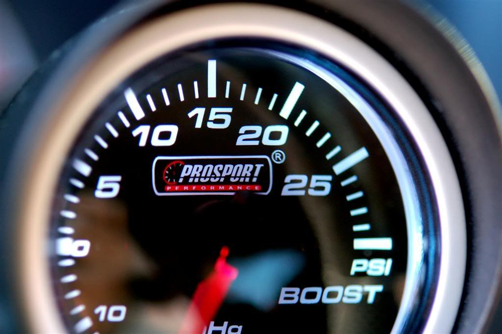

We carry the very-affordable Prosport Boost Gauge.
(Shown with the white LED lighting enabled. It also lights up amber.)
