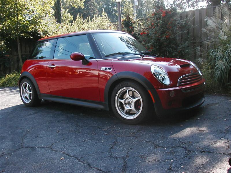

Trying to outfit my wife's car for STX competition, its a factory JCW car, and would like to use 15" wheels if possible. I know a couple 15" wheels fit, just trying to figure out what sizes fit over the brakes. Cuz I know its possible. These enkei's do, and so do the Kosei T1-S, just wondering what others might work. Do Konig Heliums fit? Anybody know? Also, if you know of a particular 15" wheel that does NOT fit, that information is welcome also.

all 4 work!
Kosei K1 TS
OZ Ultraleggera
Motegi Tracklite
Motegi Tracklite 2.0
Alex
