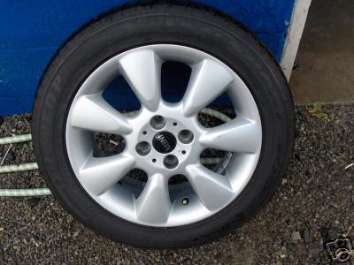

What wheel is this?
It's mentioned they have 195/55/16 tires. So I atleast know they are 16's. What I don't know is the offset, width, weight or if they will work with the JCW brakes.

16" 7-Fin Spoke Wheels
Here is the information that you wanted on those wheels.
RIM Width (inches) 6 1/2
Rim Diameter (inches) 16"
Rim Weight (kg) 10.5+-300G
Tire Weight (kg) 10.3 KG
Total Wheel/Tire Weight 20.8KG
Off-Set 48
Now, the JCW can fit on the 17" wheels, so I am also including the information about the 17" S-Lite
Rim Width (inches) 7
Rim Diameter (inches) 17"
Rim Weight (kg) 11.4+-300G
Tire Weight (KG) 9.6KG
Off-Set 48
