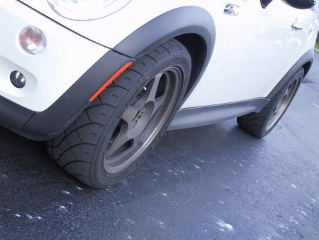

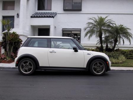

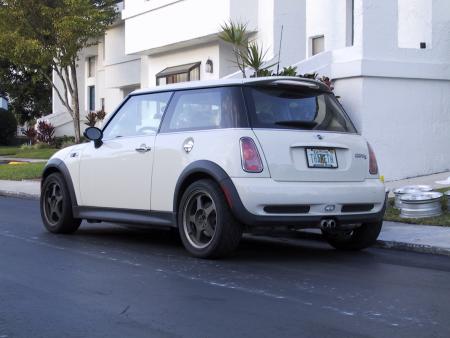

Thameth's Avatar
Thameth
Joined: Nov 2003
Posts: 1,027
From: Miami, Fl
I have a set of Rota Slipstreams 16x7 for autocrossing with a 40mm offset. 45mm would seem to sit too deep into the wheel well.
I had H&R springs and a rear sway bar with no rubbing issue's or other problems. I also ordered a set of Rota Grids which are waiting to go on my 05' soon.
I use hub centering rings with no problems and they're silky smooth on the road. I also did a track day with speeds up to 115mph with no problem.
Those pics are before the H&R springs.
