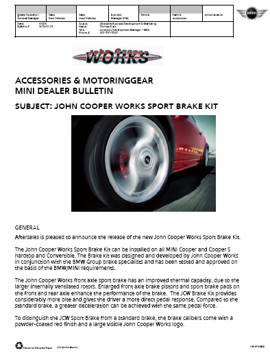

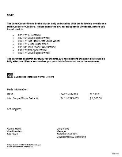

latest from MINI on JCW Sport Brake Kit
Hope the three attached files are legible.........enjoy
Attached Thumbnails latest from MINI on JCW Sport Brake Kit-jcw-bbk-page1.bmp   latest from MINI on JCW Sport Brake Kit-jcw-bbk-page2.bmp   latest from MINI on JCW Sport Brake Kit-jcw-bbk-page3.bmp

Thanks! Damn, it doesn't look like my 16" R90s will work with the kit unless they don't have them listed for some reason.

Also a potential problem for people running dedicated winter & summer wheels; have to make sure both sets of wheels are compatible (our 16" winter steelies certainly won't be)......
