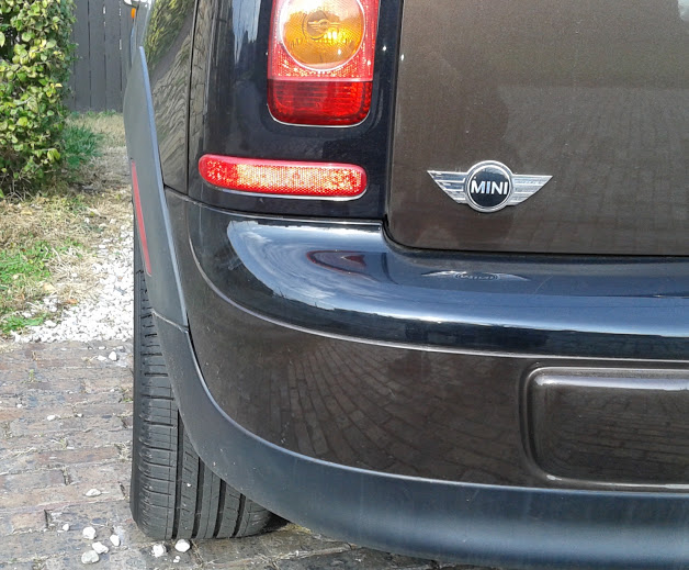

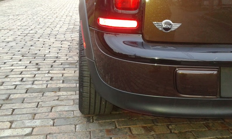

Michelin Premier A/S 205/50/16 [replacing OEM 195/55/16 run flats] flush on 12mm spacers. Third pix was taken before spacer install.

Places tire right flush with the Wheel well edge. Nice. Take a shot of the whole side!
