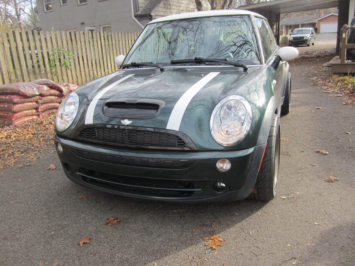

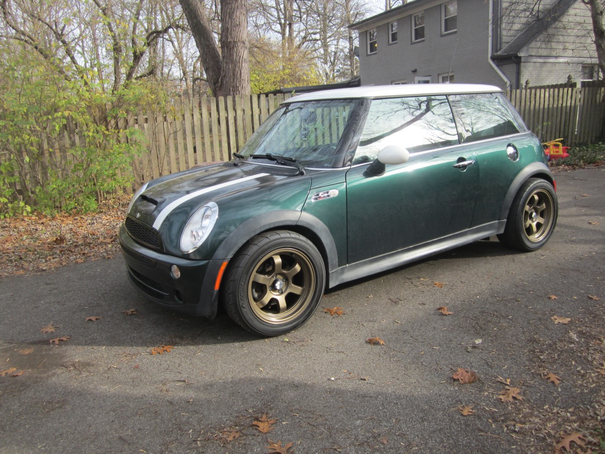

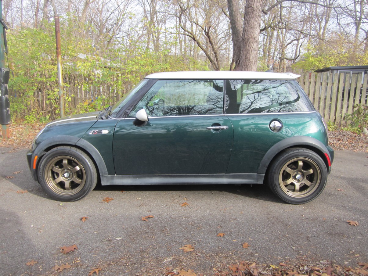

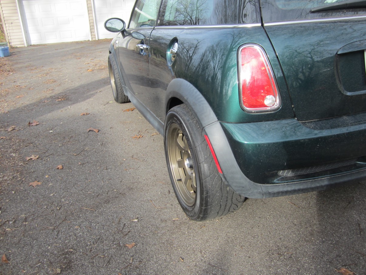

Pretty much decided they are too big/not the right fit and took them off today. Got a few pictures before I did though.

Anything below a 35mm offset is pretty extreme

That's a shame because they are a nice setup but that offset is too much.

Take those wheels OFF! If you are a fast mover and roll over a big dip those plastic wheel arches will slice your sidewalls (not tread) just like a razor. Kissing DEATH is not a nice experience.

Took them right off after one short drive. Looking at the wheel the offset is actually 25.
