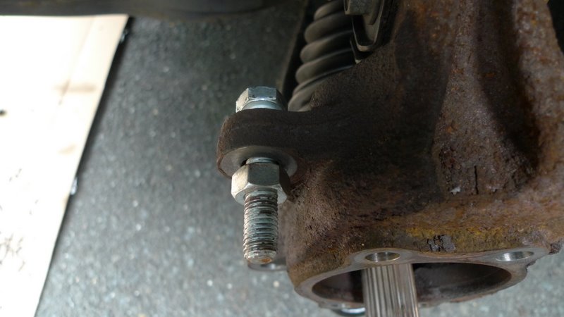

Here's a trick I've used on other cars but haven't tried on the MINI yet.
You remove the brake caliper and get a bolt with matching nut. The bolt needs to be smaller than the caliper mounting hole and longer than the distance to the caliper. Pass the bolt through the back of the mount and thread the nut on. The bolt should spin freely in the hole and you hold the nut with a wrench as you turn the bolt with a socket. You may need to put a shim between the bolt and rotor if the bolt is pushing against the swept area of the rotor and you plan on re-using the rotor.
If the rotor doesn't pop loose right away, try hitting it with a hammer with the bolt still torqued against the back of the rotor.
With the rotor still bolted, I've also used this method to pull wheel bearings.
A lost easier to see than explain so here's a pic (not a MINI).
