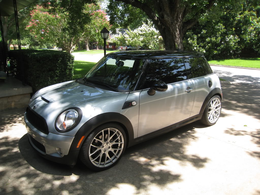

The term is "concave".
It doesn't work on a MINI because there isnt enough room in the fender for wide wheels that are deep concave. If you want a concave wheel like the one you posted, you will need 9+ inch wheels.
It is possible to fit 9inch wide wheels in your MINI, but you will either need to run wide fenders, or have a massive amount of negative camber to make the wheels "fit" in the fender.
Of course there are wheels under 9 inch that have a very slight concave face to them, but no where as concave as those.
The Breyton GTS-R for the MINI is slightly concave. (Combfilter's R56)
