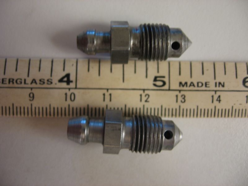

Give Speed Bleeder a land line . DO NOT chance getting the wrong part . The Lady at Speed Bleeders knows the part # if you get to talk with her , a super lady ,most helpfull indeed.
The # on my packets are SB 1010S-SS M10 X 1.0
Mine are the Stainless .Please buy Direct from Speedbleeder , You won`t be sorry you did .NO I am not associated with Speed Bleeder either.
This is a pic of the Original bleeder the NEW bleeder should be THIS SIZE .(note Thread length)Speed Bleeders anyone?-img_0042.jpg
