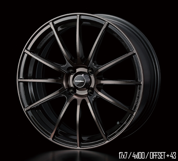

oh, and here is a picture of the wheels I am thinking of and they only weigh 15.256 pounds per wheel as well
again, thank you so much and I really appreciate the help
