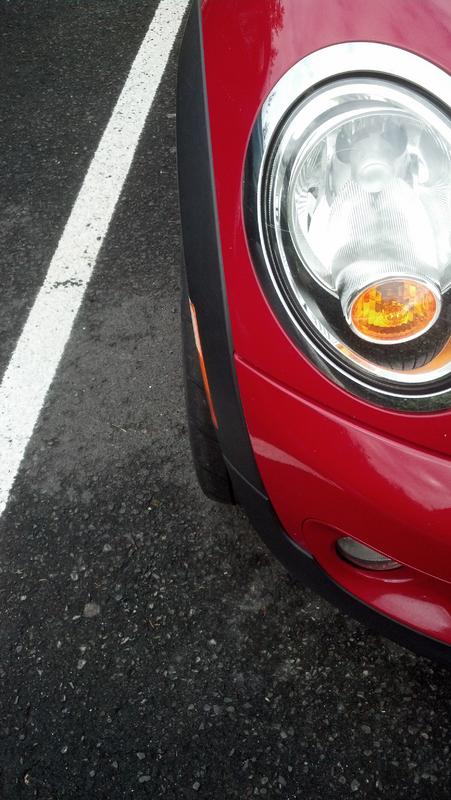

Here we go (part 1): 3 pics of front 225/50-16 Honkook RS-3 tires on stock 16x6.5" ET48 wheels. Sorry about the dirty car and wheels - it rained last night.
No rubbing under any conditions. Not even at full lock at the front wheels. It's tight, but even the over-sized (measured at ~9" = ~229 mm) 225/50-16 tires fit all around.

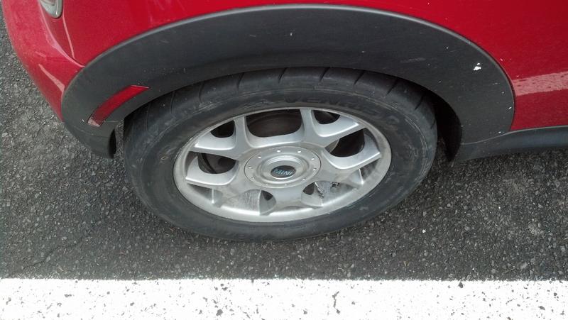

Here we go (part 2): 3 pics of rear 225/50-16 Honkook RS-3 tires on stock 16x6.5" ET48 wheels. Sorry about the dirty car and wheels - it rained last night.
HTH,

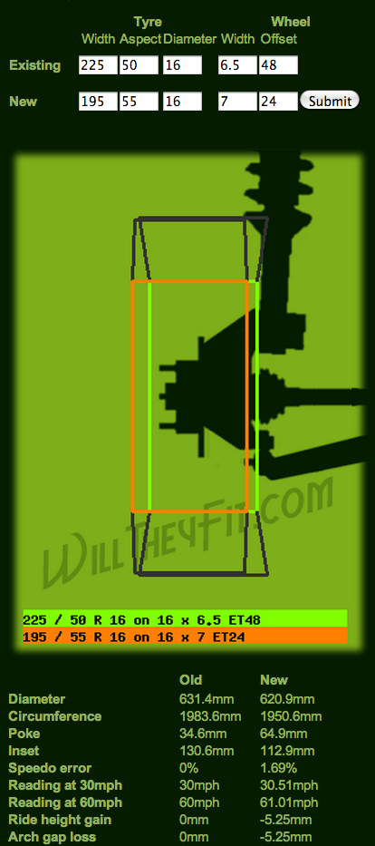

To give you an idea of how it would relate to your proposed setup:

Nice visual, though I think it only illustrates the position of the wheel based on the specified wheel size and offset. Old/New calculations do take the tire size into account correctly.
alex

What else would it base the position on? Its not a vehicle specific illustration, it just assumes hub position is unchanged. It cannot tell you fender/strut clearance, you have to infer that based on the real life position of the old wheel/tire vs the new.
That being said. Your tire is pretty much exactly in line with the fender. As we have already established and is illustrated above the OP's proposed tire will sit ~7mm (1/4") farther out horizontally in reference to the fender it will also sit ~5mm (3/16") closer vertically because of the additional diameter. Not only does this have the potential to not look good IMO, but it also has significant chance of clearance issues with the fenders(rubbing).
