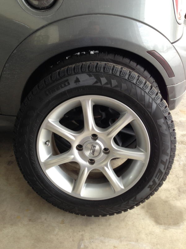

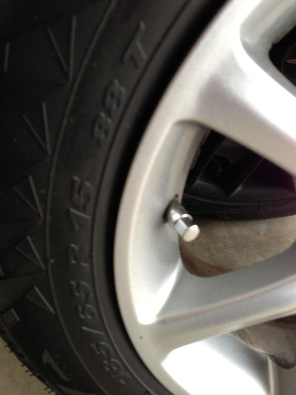

The bolt pattern on your car is 4x100. However, that doesnt mean they all fit. You also have to deal with hub centering rings with aftermarket wheels. For example I have a set of Sport Editions with Parelli winter tires off my 2005 that I wanted to put on my wifes Scion. Same pattern 4x100, but they don't fit without some work. I had to get different size hub rings etc.
Depending on where you are I might have what you need. I am not going to keep my winter setup so if you are interested I can put you in a set of 15" wheels with winter tires that have 2000 miles on them. I sold my car after last winter so I don't need them. I just haven't taken the time to list them in the classifieds yet.
Attached Thumbnails 15 inch wheels-img_0591.jpg   15 inch wheels-img_0592.jpg   15 inch wheels-img_0593.jpg
