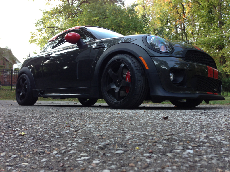

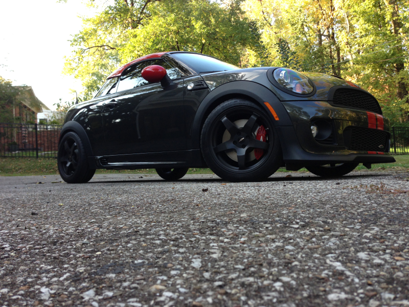

Old Oct 20, 2012 | 10:26 AM
  #38
TerminalVelocity's Avatar
TerminalVelocity
Joined: Nov 2011
Posts: 1,073
Here ya go. It's all I have on my phone at the moment. I can send more if you need them.
These are Michelin PSS 215/45R17's. the car is lowered on NM eng RS alpha springs. Absolutely no rubbing issues. The angle of these pics make it appear there is more fender gap and ground clearance than there really is.
Old Oct 20, 2012 | 10:32 AM
  #39
walk0080's Avatar
walk0080
Joined: Jun 2010
Posts: 1,800
