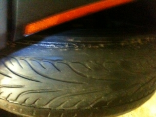

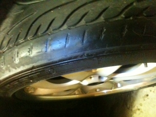

I have an 2006 MCS with 11K miles on it, I bought it with 3k. I have had it about 6 months now. The tires seemed to be slightly dry rotted when I got the car but since they only had 3k miles on them I figured I would let it ride for a bit. Well I noticed the road noise got worse so I took a good look at the tires today and found the inside edges of the tire worn extremely bad to the point I see the belting.
The tires are Dunlop SP Sport 9000 run-flats on 17 inch stock wheels. My question is should I be concerned about alignment/suspension problem or contribute it to the dry rot causing them to wear bad. I am not a crazy driver but do drive spirited from time to time.
I did a search and found some threads on the inside wearing but this seems to be both inside and out (inside definitely worse).

Yep, you got an alignment problem. At least now you have an excuse to replace your run flats, right?

Underinflated tires wear both edges.
OK - just checked... they are under inflated.
Yes I hate the runflats so I guess I am officially tire shopping. I see a ton of threads about tires after a search so I guess I gotta figure out my budget.
Thanks for confirming the alignment issues!
Good thing they were runflats, because it looks like you ran them flat for a couple thousand miles. Better check your pressures more often than never.
Regular tires are much better for ride quality, so at least you get something for your money.
