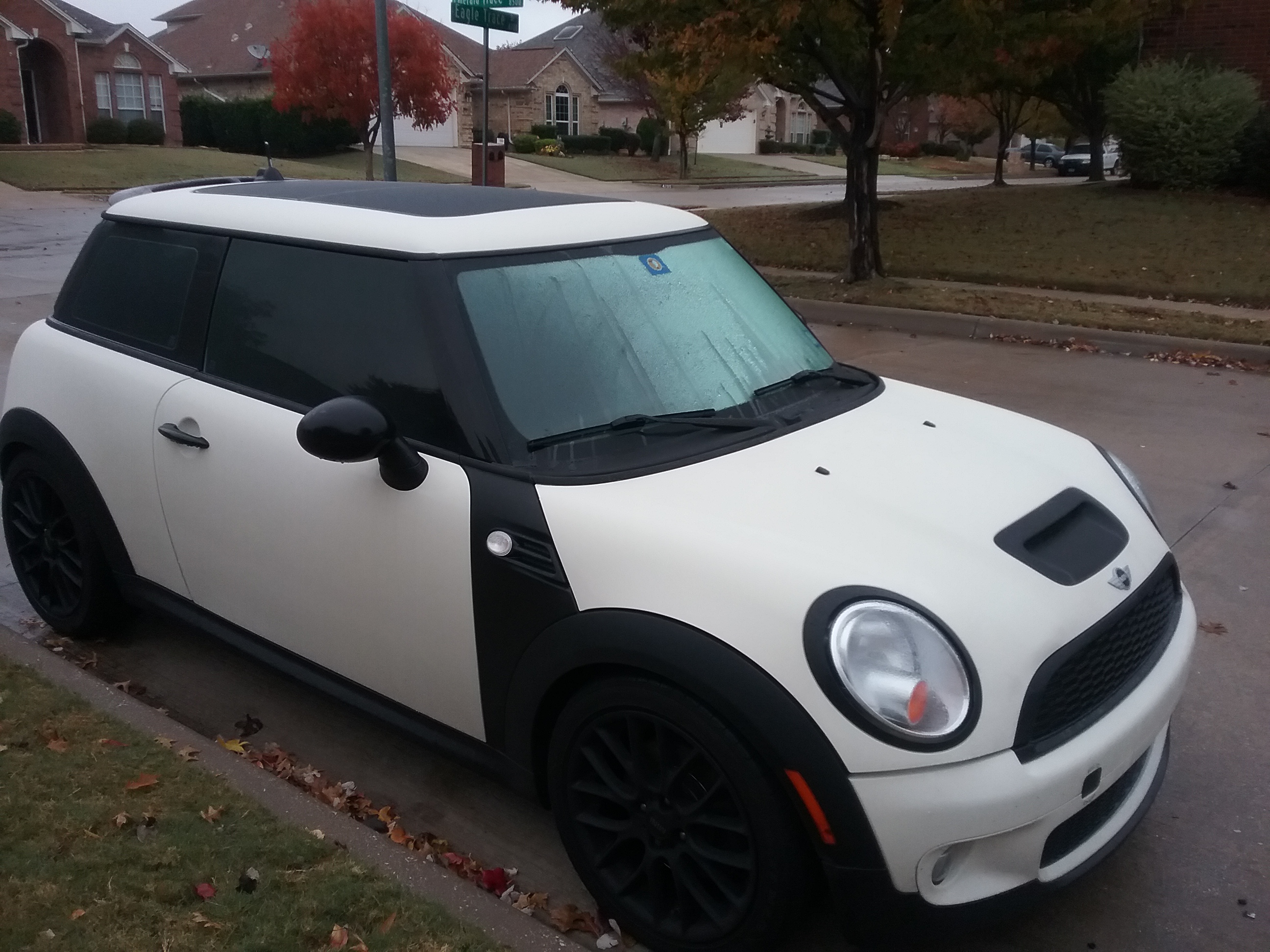

Hi all, you thoughts on xxr 17x8.25 et 25 530's for 09 mcs Lowered 1.40" .
Currently the 17x7 om with potanza 215x45x17 rear and 205x45x17 front need the fat look.
Thx
Ben
Thx
Ben
Will poke quite a bit. I have 15X8 +20 with 225/50 and it pokes too much.
Also I think you shouldn't get knockoff wheels
