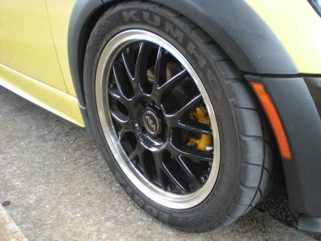

I've stuffed 245/35R18 onto the R56, on a 18x8 +45 wheel with a 3mm spacer to make it +42. (We needed the spacer because the tire contacted the strut without it.) It didn't quite fit -- rubbed the plastic arches under any kind of heavy suspension compression. With trimming of the arches it might work, but I'm not sure how much trimming you'd have to do.
--Dan

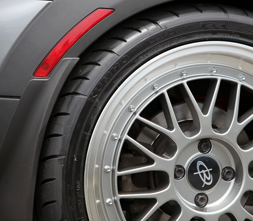

these tires look OK at 225/45/17
http://www.vadriven.com/forums/showthread.php?t=302880
They are too tall and will rub. Go with a 215/45R17, or a 235/40R17. A 225/40R17 would be ideal, but you can't get that size in a street tire. (Hoosier makes a race slick in that size.)
--Dan
Mach V
