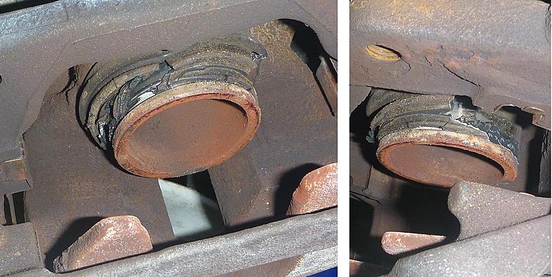

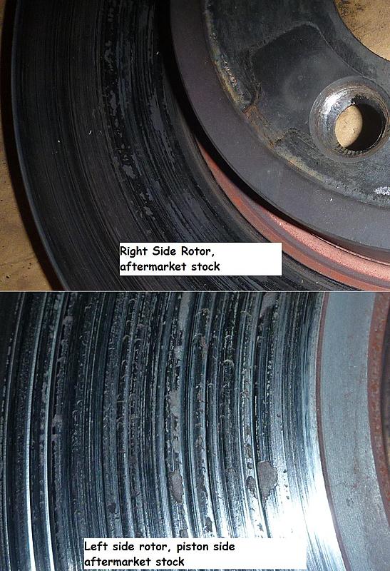

Back to basics – stock rotors. Rebedded the Carbo’s and went to Monticello. The day could not have been better. Everything performed fantastically. No fade; no lumpies. And it was a warm day – mid-80’s. At the end of the day I still had half of the front pads left. 3 days on the first half, I figured another 2 days on the other half, at least.

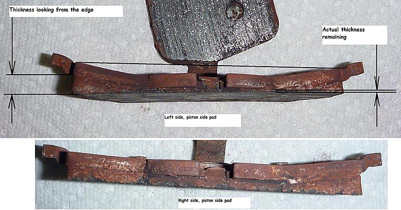

Boy could I have not been more wrong. I headed to Monticello with half the pads left thinking no problem (packed a second set just in case though). Toward the end of the last session (2 hr of driving) the brakes started to feel “funny”. They acted like they faded out, the peddle would go down a little more and then everything was fine. I will admit that I was a little harder on them. But when I went to change the wheels to my street wheel/tires, this is what I found (see thumbnails, sorry I don't know how to upload pictures)
The pads next to the pistons were over heated and the metal backing plate bent around the piston. The rubber boots on the pistons were over heated and were destroyed. And the Aftermarket rotors started to shred. It is like they were cast wrong and have a seam under the surface. You can see where the surface is worn away and that seam is exposed. While I didn't feel anything I would attribute to this, I do think that this contributed to the accelerated pad wear. Anyone out there have any thoughts about the rotors?
By the way, I did put some brake temperature paint on the rotors and I am in the yellow zone (1100 to 1300 deg F). So I think that the rotor size is OK for my current experience level and the XP-10s are about perfect.So a few things I am taking away from this. 1 - with stock calipers, don't look at the side of the pads to see if you have enough to go back out on the track. If I had gone out one more time with these, I would have lost my brakes. 2 - as you move up in track experience, make a brake upgrade your 1st mod. I never would have guessed that I would have done this to my brakes before seeing this. 3 - I do think that at a minimum, even on your first track day, a brake pad upgrade to a real race pad for the fronts is a must. 4 - at my level (intermediate level driver) I can only expect to get 3, maybe 4 days out of a set of race pads with stock calipers.
As for me, my season is done. I am reassessing what I have learned and working on a brake up grade. My objectives are to retain my 16" stock street wheels for the crap Northeast roads. But I think that a multi piston caliper is a must to even out the brake pad pressure on both sides of the rotors. I would not expect rotor temps to go up (unless I learn to brake later or go to R compounds), but I do expect this to help with pad wear and temperatures. The pads on the multi piston calipers are larger, which should give better heat dissipation and have better wear. I will stick with the Carbotechs. One other thing - I have read and been told not to mix brands of pads. So it will be Carbotech XP-10s for the track and and will use the Carbotech Bobcats for the street. I just hope that changing pads with the multi piston calipers is easy
Everyone, feel free to comment and add your experiences. I have proven that I don't listen well
