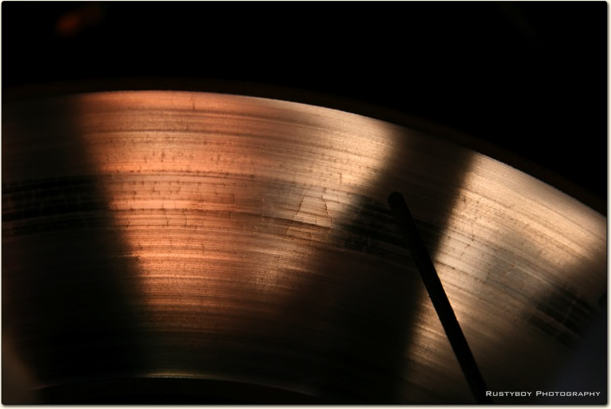

Anyone think this is any cause for concern? I'm swapping them out soon anyway, but I thought i'd get some opinions. The cracks appear to be on the surface, but running my finger along them, it appears to be smooth. The car is tracked hard, but i've never seen hairline fractures like this in solid vented rotors, typically only in x-drilled rotors.
Front Rotors:
By comparision my rear rotors are completely smooth, with no visible cracking

looks like the pad isn't the right shape. The center where it is cracking is going through more rigorous heat up/cool down cycles because of the pad (my best guess).

That looks like standard heat checking to me, I don't think it's cause for concern. Here is a pic of the rotor I had to throw away last year, the crack was big enough to get my fingernail into.

I just swapped rotor & pads out on my car too. Those rotors look exactly like my front ones. My rears were also free of cracks. I'd say for driving on the street it's not a big deal. On track use wouldn't be advisable.
Those aren't wear cracks they're heat cracks.

This is actually a good rule of thumb to follow. My rotors look similar to the ones first pictured by the OP and I'm not stressing. With the amount of heat that builds, espespecially with HP aftermarket pads, there's more than likely going to be some very (and I mean very) minor cracking. You more than likely won't see this with a less hard OE pad.

The consequences of a failed rotor on the race track make me say if you track a car with cracks like the op's you are taking a large risk. My call was to replace them.

Normal wear and tear for an oem rotor enduring high temp use. The added Cf of a good pad elevated the work of the front rotor to the point it is now operating at the limits of its capacity and stress cracking would be considered normal.
Not a lot you can do about it. Buy replacements of low cost knowing you'll replace them often or consider a BBK for the added mass. Air ducting to help cool the oem part may by you some time too.

Wouldn't this be a case of the pad material on the rotor showing some cracking and not the rotor?

Todd,
You don't think this is just the pad material "cracking and flaking"? From the discoloration it would seem to be pad material not rotor.

I still read this as thermal stress cracks or "heat checking" as it's often called. In short; an over stressed rotor operating at the peak of its duty cycle.
I'll toss out some thoughts on the dark band; pad smear from the pads chunking in the middle (need pad pic), stress cracks providing air flow to that portion of the rotor changing pad to rotor contact, or iron particulates tearing from the rotor surface and cracks smearing on the friction surface.

So why the small band of dark material (pad material) only in one area???
Pull the pads out and put a straight edge on the back side. I have $20 says the backing plate looks like a banana. All the work is being done at the center of the pad due to the pad deflection under the required high pressure being exerted upon it. As it gets hot it begins to deform which only goes to make the center portion run hotter and hotter...a slippery slope that does not get better.
Now, this situation would be a good cause to invest in something like the caliper stiffening bushings, correct? That's if the OP wasn't going ***** to the wall to a BBK.

At high temperatures the pad deforms and bows out in an arc (See Banana Comment). This concentrates all the heat and pressure on a single point on the rotor rather than across the entire pad swept surface.
Todd can likely explain it better than I can, but it's not something that a stiffening kit will solve. Unfortunately if you're going to be tracking your car on a track with intensive braking points, you need a BBK, or at the very least you need to expect to change your rotors out every 8-10k miles.
