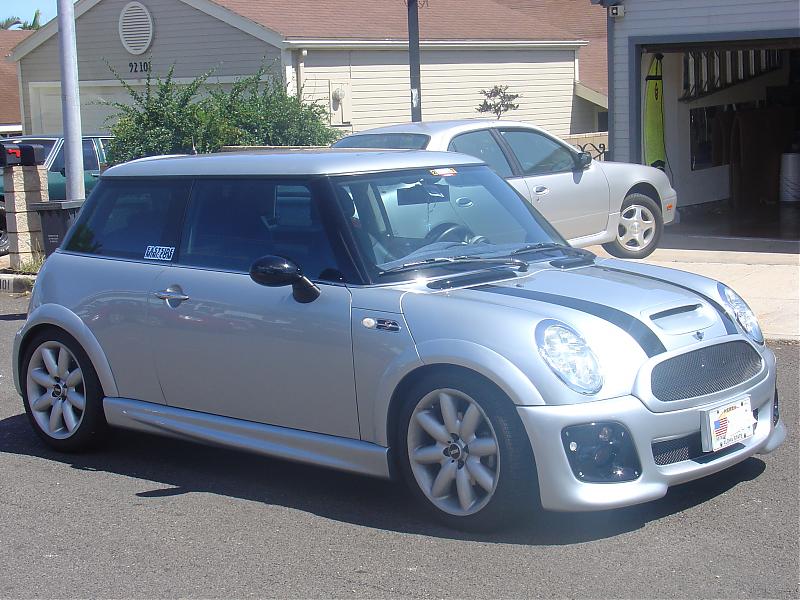

I have H & R Spring installed on my MCS about 1" drop and thinking of replacing them with stock... Reason ??? I had the Orciary body kit and its too close to the ground that I had to slow down on every pump and carefully park to avoid damaging underneath. I am willing to sell them at very low cost or best offer. I hardly drove the car except when my son comes home fron Boston. Of course plus shipping but if you're in Hawaii I am willing install them for you. ...

Here is the pic..
