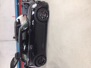

Got Lightweight Wheels - Now Floaty Suspension
I ended up getting some 17x8 wheels that are considered lightweight at 17lbs each corner and WHAT A DIFFERENCE in take off speed and acceleration in general! I even ended up getting bigger more grippier tires. Stock was the Michelin runflats in 205/45/17, and my new tires are the Firestone Indy 500's in 215/45/17, but now feel I should go wider because I don't have any grip. I do have some basic mods on my car that's improved the power, but with the lighter wheels on I don't have that heavier planted feeling anymore When rolling highspeed over bumps, the front end is squirmy and lofts over bumps and takes away my handling confidence of the car! This is DEFINITELY NOT WHAT I WAS EXPECTING! Car seems worse now with the lighter wheels on to where I HAVE TO HAVE a tight grip with both hands on the steering wheel in order keep control if I'm ever gunning it and the road is bumpy. Its only relaxing to drive if the road is smooth.
I'm wondering is there something I can do to gain better steering control of the car or is this all defaulting to a suspension issue where I need to upgrade?
HAVE NO CLUE HOW THE PICS ARE SIDEWAYS: they look rightside up when I uploaded them.
Attached Thumbnails Got Lightweight Wheels - Now Floaty Suspension-jcw-new-wheels.jpg   Got Lightweight Wheels - Now Floaty Suspension-rota.jpg
