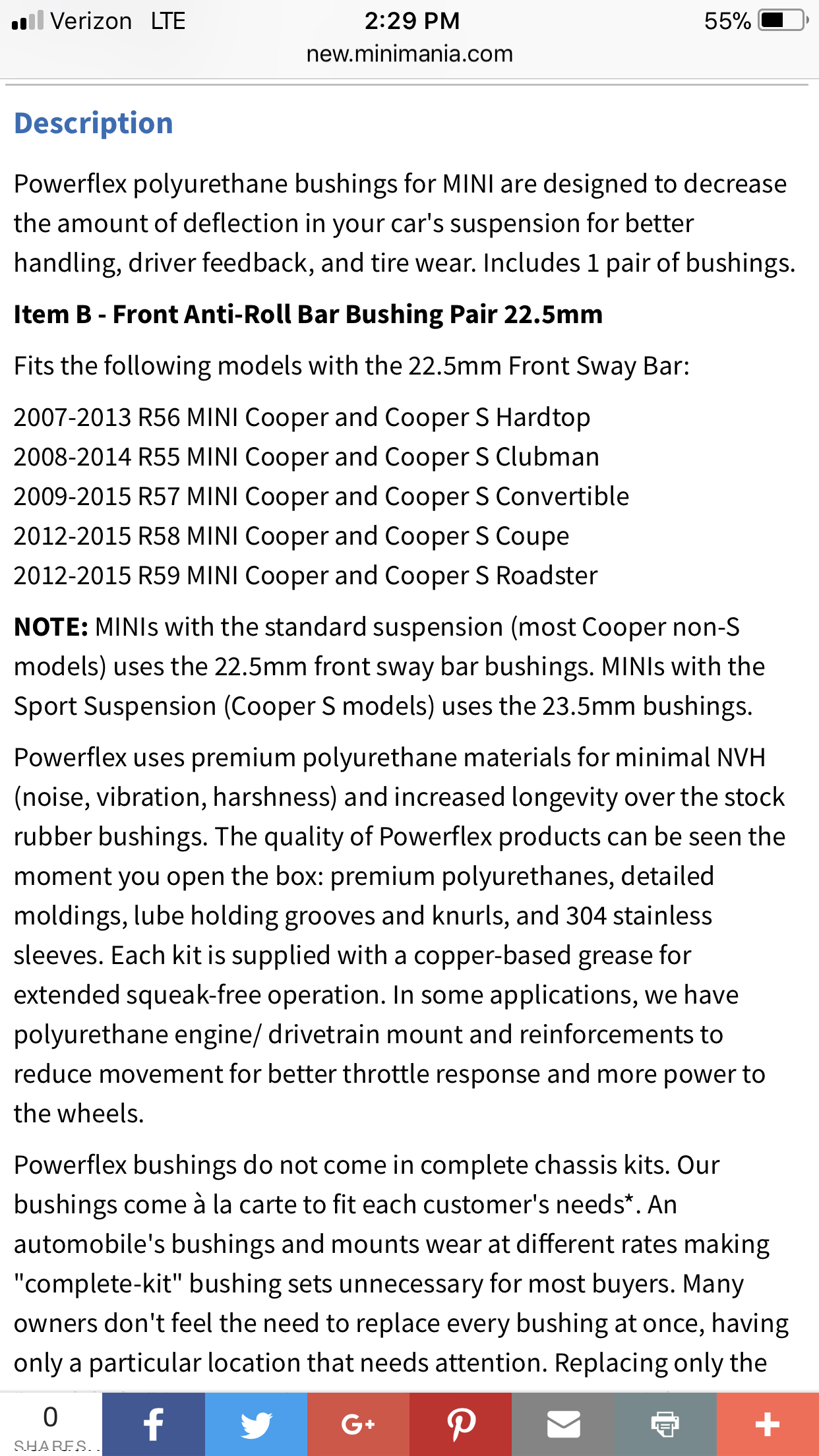

I called ECS and they said the 2011 S is 22.5mm but on the Mini Mania page it states they are 23.5mm. Can someone clarify which ones I need to order? See screen shot and notes section, hmmmm... thanks!
Ps I did not see 23.5 for powerflex either!

Non sport 22.5 , sport 23.5. Yes there is no PF or poly for the 23.5. They are all 24 and 22.5 for the poly.

Hopefully the 22.5 I ordered from you works as mine is not a JCW. Thanks again.

There is a sticker on the sway bar that says the size. It's hard to read, but it can be done. I jacked my car up, put it on jackstands and used a mirror to read it.

Now that is creative! The 22.5 worked on my Mini S and she is feels great! Big difference not having the wheels clunk around
