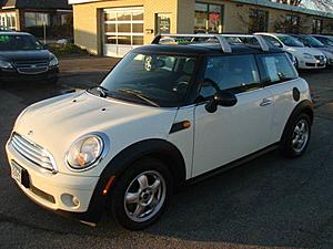

i could not reach them either , but i did find a site/guy that makes lift blocks , i think im going to try his once summer comes back around , here's his site
http://journeysoffroad.com/mini-cooper-lift-kit.html
http://journeysoffroad.com/index.html
its called http://journeysoffroad.com
this is what i started with
good luck man post some pix when/if you lift
Attached Thumbnails Off Road R56 Mini Cooper With a Lift Kit-89a79ef9-89db-494e-812f-df0642a2fc61_7.jpg   Off Road R56 Mini Cooper With a Lift Kit-23472203_10212756209571966_2442227172826157180_n.jpg   Off Road R56 Mini Cooper With a Lift Kit-23509454_10212763612517035_777889997291200055_o.jpg
