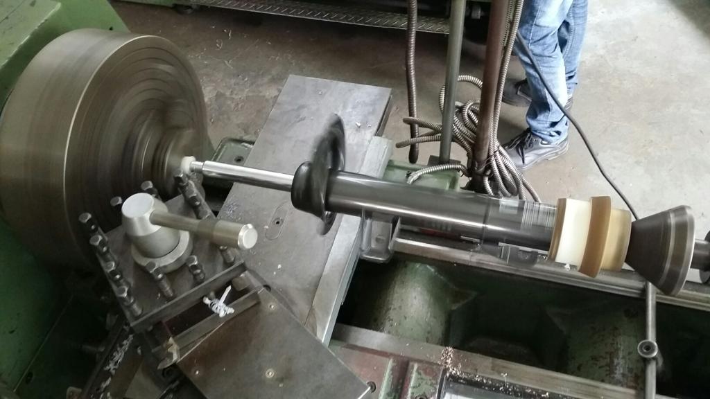

My good buddy finally found some downtime to mill the Stagg front strut tips to factory standard diameter & specs. The set was from that batch which had oversized rods that won't fit our strut mounts.
Name:  image-c531f181d463d8f861a4ab912332c49e71e16823af7d115200a91e23e0ce20cb-V_zpsf21wfnnc.jpg
The rears were fine:
Name:  image-8ea70088f4fc5aa3bda89a75f956e42740c56b7e7306766478b0c4de9468d036-V_zpsp6s0fkgw.jpg

Stagg on the left, OE on the right. For some reason, Stagg used a different thread to take a smaller nut. These Chinamen must've thought it a wise upgrade.#$%^&@
