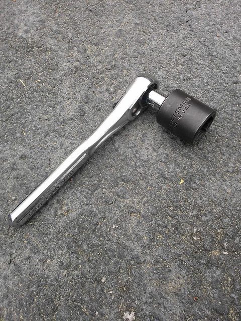

But wont the bolt just spin if you cant hold it from the side closest to the gas tank?
I checked Sears today, they didnt have anything that was 1.5" long.

Round about way of doing it is to get an inch long socket and place an adapter on it. I believe my socket was 1/2 inch and I just used a converter to drop it to 3/8. Together that gave me the length I wanted.

Problem #1, solved....
1/4" drive ratchet > 1/4" to 3/8" adapter > 1" long 3/8" drive impact socket

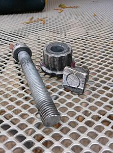

Problem #2, I have no F**KING clue what to do about this...
Square nut spun within the silly clip thing when trying to remove the bolt
Put the sheet metal nut back into place, put a small screwdriver through the holes while you tighten it so the nut doesn't spin. Mine broke off too.

From: Roswell, GA
I did that, the problem is that the nut has pushed the sheet metal out so it doesnt catch anymore. You can see it curve out there a bit.
I tried forming the sheetmetal back into its natural shape, but it just bent again the next time I tried to loosen it.
Might have to bite the bullet and take the car to Way or someone.
I must be misunderstanding you. In mind mind as long as that sheet metal nut is not rotating, you can tighten it down. I must be missing something here...

Hopefully this makes it more clear

AH HA!!!!!
Find what the thread pitch is and but a big nut and washer from your local hardware store. That'll put this to bed.
Looks like it's M12 X 1.5 X 100. You might want to get a little longer bolt (110 maybe) so it'll reach through the washer and nut. Not sure if 100 will be long enough for a washer and nut.

Well, Im trying to take the bolt out, not keep it in. I have a few ideas related to vice grips.

Yea that should do it. Work on that grip strength! Then replace with a bolt and nut.

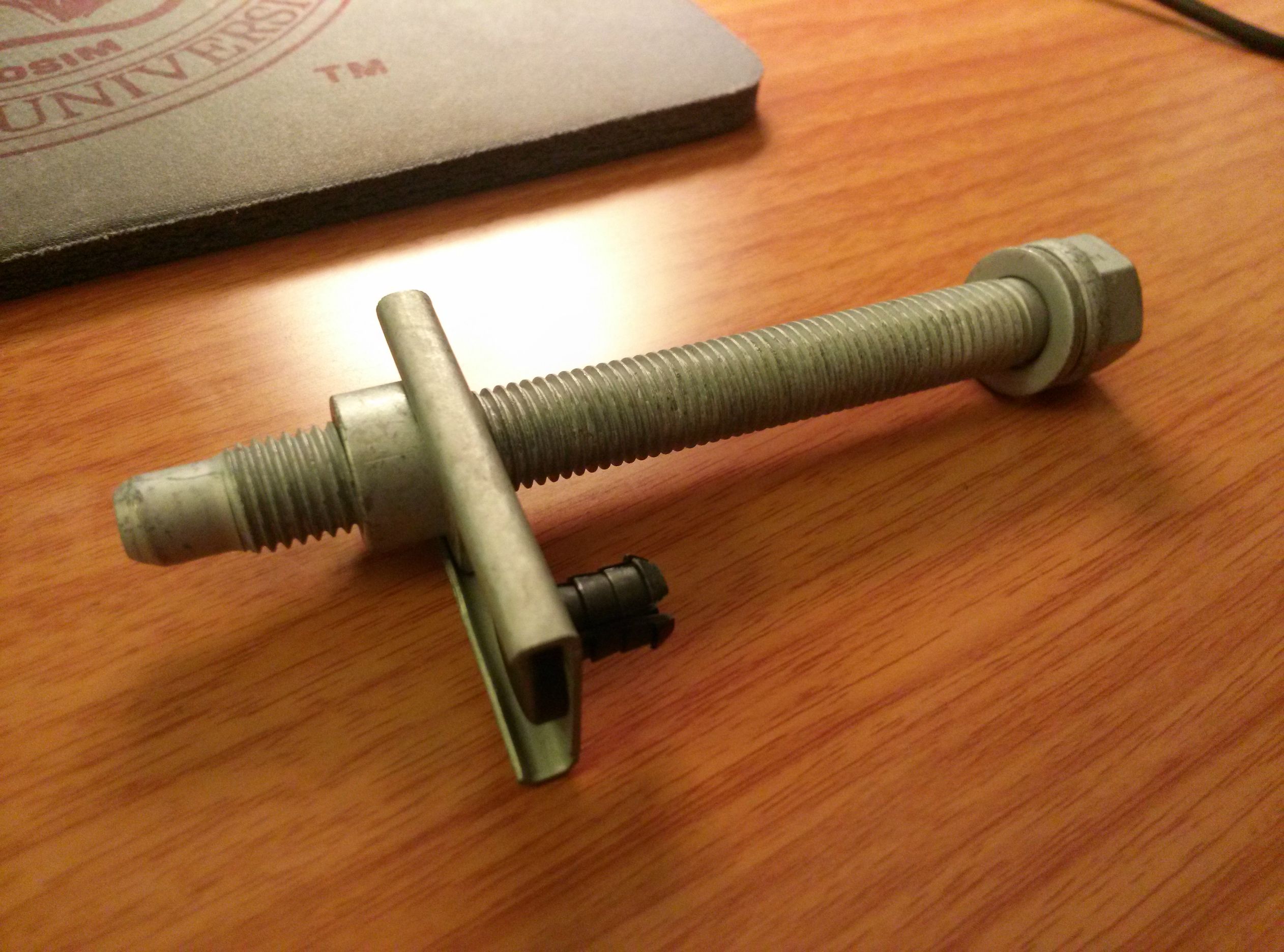

Picked this up from the dealer today. Going to have a fun little Saturday. Will probably just break out the hacksaw and cut the old one off.

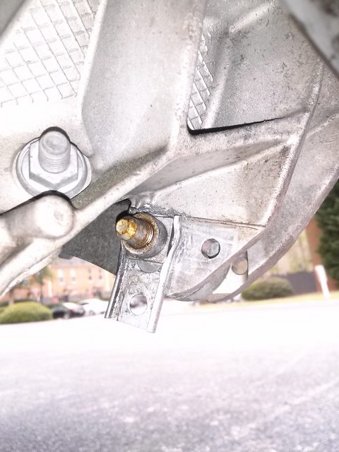

Hacksaw solved the problem
