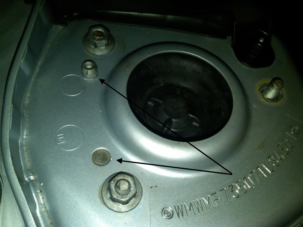

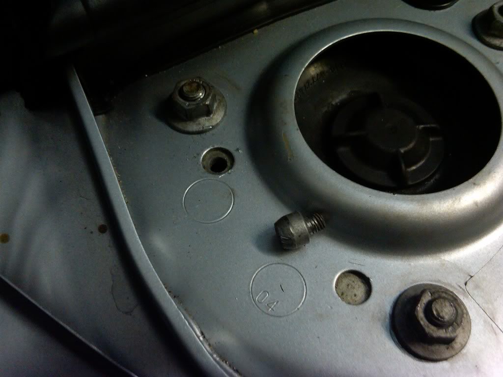

What's up with my 2007 cooper s? I have the slots to move the top of the struts, but my "nub" is metal. So I can't remove it. Anyone else have this issue.
Leave it to BMW to start a model and change it. I have a late-year '07 and mine had (they're gone now) the plastic nubs. My guess is that this is just a locator pin to make assembly easier and they quickly found that plastic was cheaper and didn't damage the paint when it went through the hole. Now, the hole in the camber plate on my '07 is about 7/32s which is smaller than the hole in the strut tower. Guessing again, the hole in the camber plate has probably not changed (no reason to if the above is right). So given the smaller hole in the camber plate and the pin fitting snuggly in the strut tower hole, the pin probably has a smaller nub on the bottom that is just pressed or screwed into the camber plate. You might try to just grip it with a set of pliers and try to wiggle/pull out or unscrew it. If you can get that out, this is the best change you can make to the car for the money (wheel alignment) and effort spent! However, it will increase your toe-in and you will need to get that reset otherwise you will not get the full benefit of the camber change and it will increase tire wear. Hope this works for you.

Just unscrew the metal nub. It'll be fine. They changed to the plastic plug in late 07-early 08 time frame.

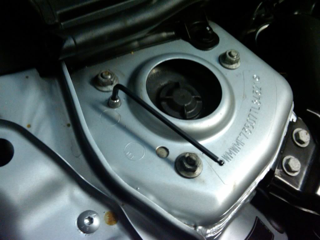

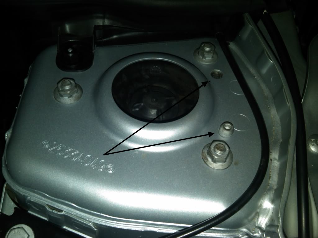

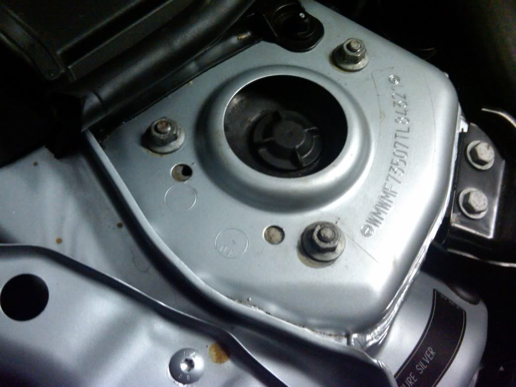

ok , yes I am total tard. I swear I am going blind. I looked at my metal nub last night and did not notice that its a #4 hex. I would have unscrewed it then and and there. I thought it was just a circle, so that is why I came and posted here. Then I went tonight to do it with pliers and wasn't getting too far. So I looked closer and realized that circle was actually a hex.. derka f'ing der...

Good pictures. That will help the next person. Now, go out and enjoy!
