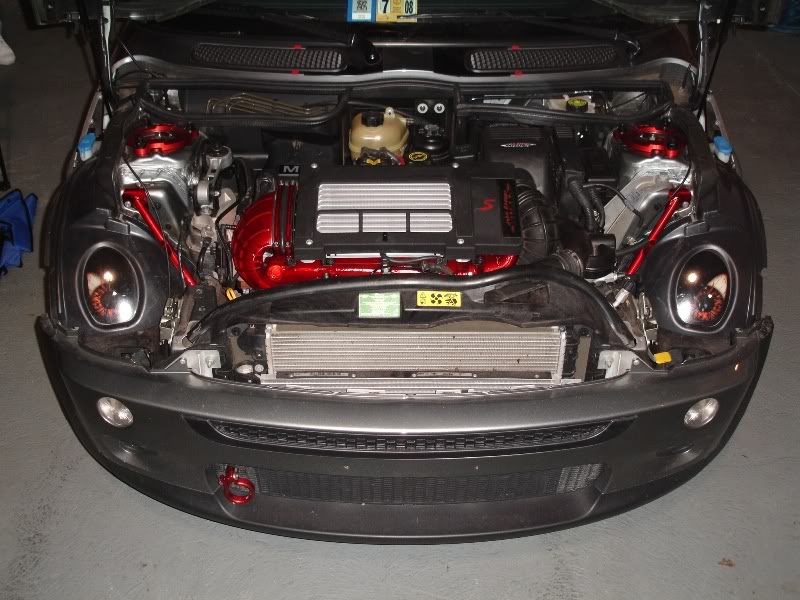

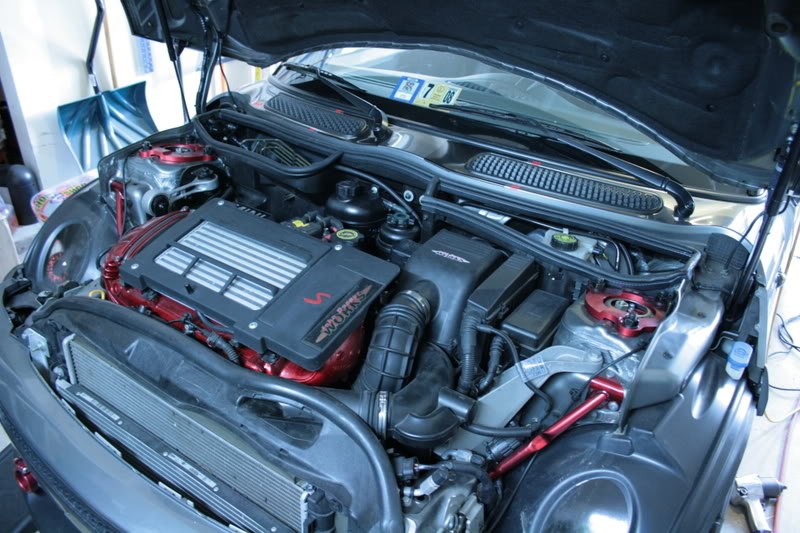

Turns out the IE Camber plates have longer studs on the top compared to the stock plates. Well the Craven Strut Tower Defender will not properly fit over the IE Camber Plate studs so they need to be trimmed.
... from
/ Flickr set on a MINI suspension upgrade.
(Are these guys NAMers?)
Apparently these are the fixed IE camber plates; I wonder if anyone else has had a similar issue? How about with the M7 SRPs?
I'm very envious of this set-up, btw: IE fixed camber plates, Craven STDs, and Koni FSDs...
As an aside.... I also seem to recall some issue with the bolts on the either the Craven or the M7 plates interfering with the bonnet release cables.... Much obliged if someone could refresh my memory on this....
Still trying to decide whether to go with Craven or M7 plates for the top half of my strut tower sandwich....
M7 and it's not the bolts...it's the sharp 90 degree transition between horizontal and vertical surfaces. The Craven plates have proper machine work where the corner has been knocked down a few thousandths to remove a sharp edge.
The M7 cut through the plastic sheathing on both of our MINI's
First, my apologies for resurrecting a long-dead thread.
I came across the following when doing a search on Craven STDs:
... from this Flickr set on a MINI suspension upgrade.
Yep, the guy in the blue sweatshirt is me (on NAM since it was MCO).
I don't recall any interference issue with the bonnet release cables... but recently, the car this set-up is installed on has been having a sporadic problem with not releasing, so I'll have to take a look at it again.
If you go with the IE camber plates and M7 top plates, you won't have to worry about the stud length. I wonder if IE designed them with the M7 plates in mind since when the M7 plates are installed one the OE top hats, there is barely enough stud length.
As far as which top plate to buy? Well... let's just say I agree with PGT.
Personally, I don't think resurrecting a long-dead thread is a bad thing... "might" help reduce repetitive posts...
