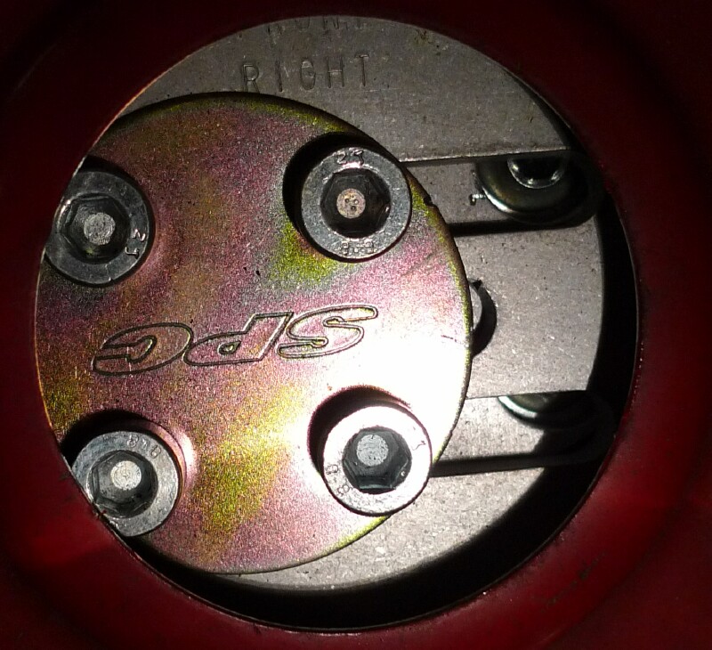

I had the SPC camber plates installed on my 04 MCS and went for an alignment.
The attached photos show the screws (the RIGHT side) are at the edge of the opening hole. If they are moved further, they are obscured and cannot be tightened. It cannot get more than -1.1 degree of camber on the passenger (RIGHT) side, and -1.5 degree on the driver (LEFT) side.
Is it possible to get more negative camber without cutting into the opening?
If you have the SPC camber plates, could you please show me a photo of where the four screws are in the opening circle, and what are your alignment numbers? What is the maximum negative camber you can get from the SPC camber plates?
Thanks.

My IE have the same exact problem, the one max out at -1.6 though, not 1.1.

works: i don't know the specifics of those camber plates, but i you use a ball-footed allen wrench, you will be able to add some camber without cutting.

I have a set of the IE plates, and they go to -2 deg without cutting anything. If I remember correctly, when they were installed there were two ways the plates could be assembled, one yielded more camber potential than the other.
Maybe the SPC plates are the same in this regard.

The SPC web site says it is adjustable from -2 to + 2 degree. I wonder if the plate is assembled correctly too.
A ball-footed allen wrench will not fit, as there is only 2 to 3mm of clearance. I think I'll replace the round-head bolts with hex-head so an angled wrench can be used.
