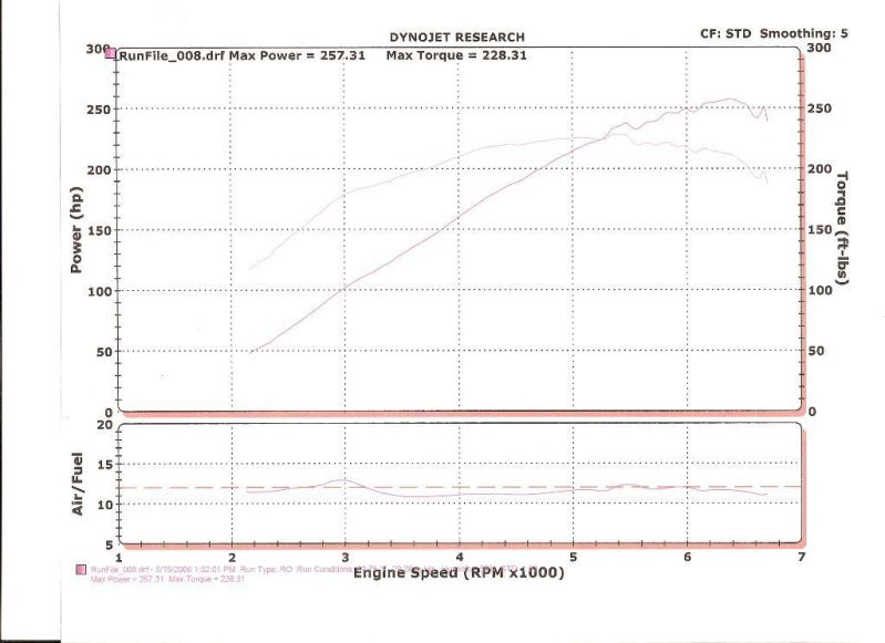

Just a guess, but looking at your dyno graph from your other post [it's very awesome of you to do that, btw!], you're running obviously leaner at exactly 3k rpm [though, it seems you're only between 13 and 14:1 and this should be ok?!?!?], so perhaps that is the root of your vibration. If that IS the source of the vibration, that's a very BAD thing, you know...rough running engines like to die . Below, I'll post the graph again...

As for the lean spot, we just couldnt tune it out, that is right before the turbo spools, which kind of makes no sense, as it should be richer. Its defintely an engine vibration, but it could be normal, but just more exagerated from the 3" downpipe. I really want to get this knocked out, as its horrible to drive at 3k!
