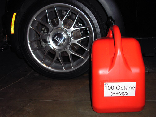

I am just a Cooper (non-s) owner, but I am curious what software your ECU has that you are feeling a difference with 100. I'm currently running MTH tuner for 91, but am waiting for a 100 update from Herr Volker Kurch.
