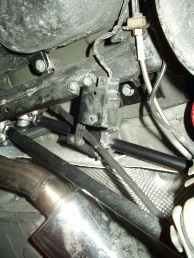

Sounds like you might have clipped one of these:
