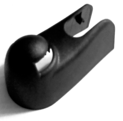

Old Jan 6, 2011 | 06:55 PM
  #43
dua84's Avatar
dua84
Joined: Oct 2006
Posts: 4
Originally Posted by golden_child
Sorry this is OT. But I remember when I got my 03 MCS the front jets shot over the car and hit the car behind me instead of at the windshield.
Now back to our regularly scheduled broadcast.
This same thing is happening to my 06' r53. Went to a local dealership and they gave me a replacement cover to test but there was no nozzle on it, so the spray went everywhere but on the window. I found this part on minimania.com and ordered it figuring that the nozzle was included....
but received the same part the dealer gave me below. Am I missing something here, or do I keep on spraying the guy behind?
Old Jan 10, 2011 | 02:15 PM
  #44
paulgraz's Avatar
paulgraz
Joined: Oct 2002
Posts: 480
From: Howell, NJ
That nozzle is definitely part of the cover - your dealer and minimania are giving you the wrong part.
Old Jan 10, 2011 | 04:05 PM
  #45
Mini Mania Info's Avatar
Mini Mania Info
Joined: Aug 2010
Posts: 37
From: Nevada City, CA
According to our data, the first image is for MINIs built up to 07/2004, and the second is for MINIs built after 07/2004.
Ken
Old Mar 2, 2011 | 02:16 AM
  #46
dua84's Avatar
dua84
Joined: Oct 2006
Posts: 4
Ken over at minimania was very helpful, even sent me the wrong part no charge, great customer service and great selection of mini related motoring gear... Finally got this thing fixed with the first part sent and helpful guys at another source up in Sun Valley, CA: Mini World, a salvage yard for mini's. Here's part that I think someone pried out of the wiper assembly:
Should this happen again (or to anyone else), I'm hoping maybe someone could identify the part and where to source it.
Shout out again to minimania, and mini world!
Attached Thumbnails Rear Window Washer Not Working-mini-rear-washer-nozzle.gif
