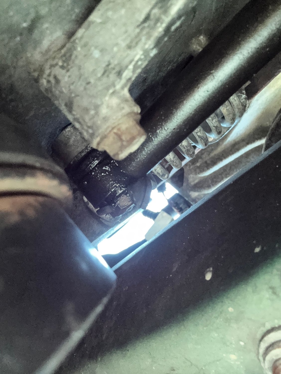

I also jacked up the car, pulled the wheel and fender liner off and checked out my belt assembly. And I discovered that it looks like the shock on my tensioner has failed. With the fluid that’s covering the bottom side of the shock here, I would say something broke there lol.
Should I still just buy a whole new assembly, or replace the shock and probably the bushings too for future proofing? It looks like I can get just the shock for $30 or so.

The bushings on my failed tensioner damper looked the same - destroyed. I was surprised because, as I said, it was only a couple of years old. I was dealing with my supercharger and happened to notice the blown out bushings. I happened to already have a new tensioner because I had ordered 2 by mistake the first time. I then decided a new idler and belt is cheap enough to throw on as well, so I did.
I would get the who tensioner assembly since it comes with a new pulley on it too. You don't state the mileage on your car but a 2005 model year car is 20 years old now. I am generally in the camp of refreshing the entire system when I have to deal with worn out components - the accessory drive system in your case - since they all wear together. Sort of a "while I'm in there" thing. Spend the money on all that stuff now and spend a few hours installing it all, then you know the whole accessory drive system should be good for a while. Not including the alternator, compressor and supercharger of course.
