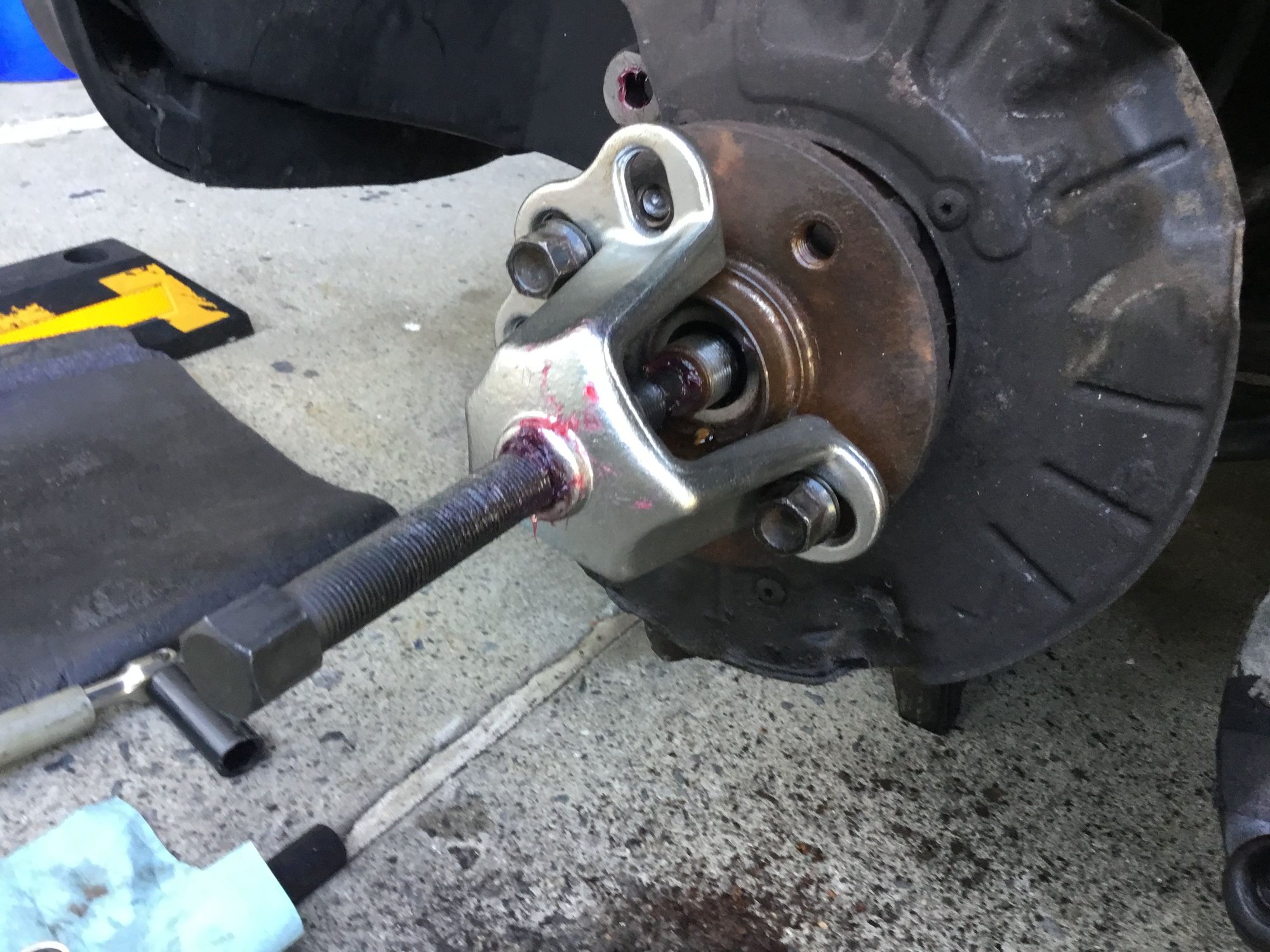

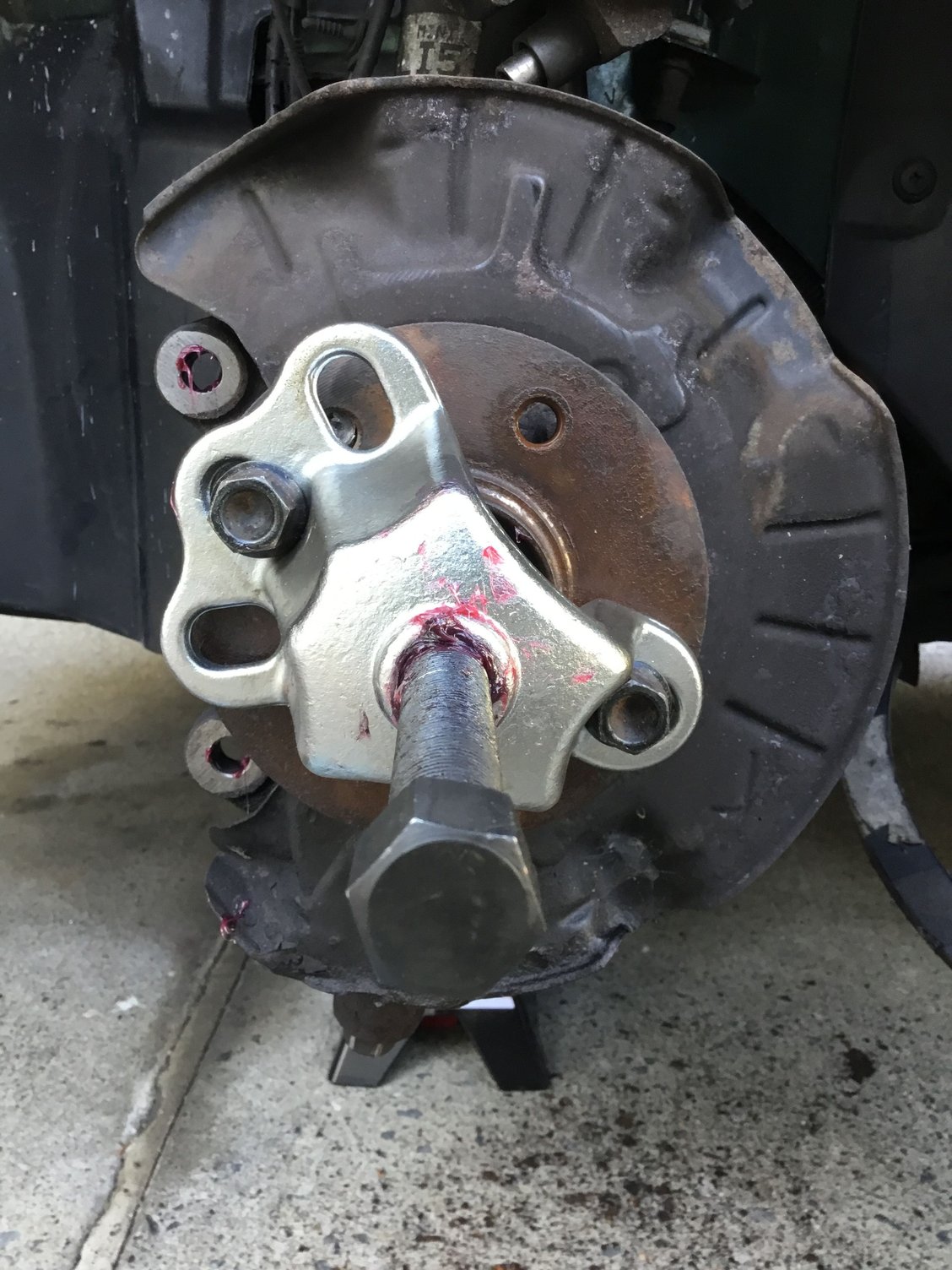

Hello,
I am currently trying to remove this knuckle assembly, the only thing remaining is this axel and bearing., isn’t this axel is supposed to move/slide along the bearing spline? This thing is stuck to the bearing., now i am using this puller tool, been very careful not to break the bolts.
Am i using this tool correctly?
Car is R53 - 2004 93kmiles

Have a look here? About 4:10 or so, when he gets into the same argument. I wouldn't use that tool unless you are CERTAIN that the inner flange (secured by those 4 13mm bolts) is NOT rusted to the spindle. Is it REALLY the splines you are arguing with?

The four bolts on the back on the hub must be removed. They are still visible in the first picture.

Hi Cooper48 and Cmt52663,
My steering knuckle pinch bolt snapped on me. Since I have he replacement knuckle ready on the side now I am ready to bring down the whole strut down to ball joint, tie rod, links and bearing /cv axle.
See see all them are already loose lower outer ball joint, links, tie rod ---- the 3 strut tower nuts are still there. The only thing that is holding me is this cv axle it's stuck to the bearing. So even if the bearing is still screwed tight to the knuckle the whole strut assembly is loose down to lower ball joint and tie rod., unless I am missing something here, the axle is supposed to slide out of the bearing? no? maybe little tap there and it will come loose? Isn't this tool pushing the cv axle's spline out of the bearing?
check this video... I know it's a honda civic., around 2:45 ----- so on the mini R53, the shaft is supposed to move like that correct? so now i can the disconnect the ball joint below and the tie rod nut, pull the knuckle towards me and the CV shaft will slide out correct?
